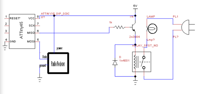

The receiver module will need to have a circuit that decodes the signals from the RF receiver and decides whether to turn on its output pin based on the variable it decode. It will then need to turn on a 5 volt relay. To make this circuit work, I used a 433mhz RF receiver that receives and amplifies the transmitted signal, an ATtiny to decode and process the signal, and a transistor to activate the relay. Everything was soldered on to a piece of perfboard that was cut into quarters. First, you need to place all the components on the board in the same way I placed them. Make sure not to actually solder on the ATtiny chip! Just solder on the DIP socket. After that, solder together all the connections underneath according the the schematic. After the circuit board is soldered, connect it with the power supply and the output receptacle. The receiver circuit is now complete!
Step 6: Adding Receiver Antenna
To ensure the proper function of the receiver modules, the RF chip will need to have an antenna. This can be easily made from a 10cm long piece of wire soldered to the hole on the bottom right corner of the chip, as shown in the picture.

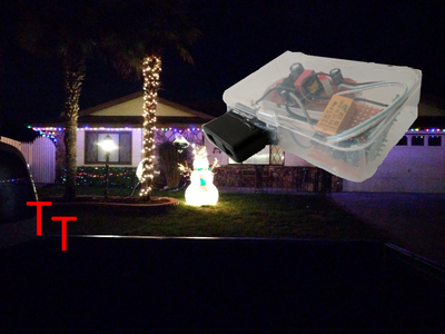

The receiver circuit will need to be housed in something. I chose to house it inside a plastic box. The box will need to be able to hold all the components: logic board, power supply, output receptacle. The first step to building this box is marking out where holes will need be so the plug and output receptacle can stick out. Then, use a soldering iron to cut holes in the plastic along the markings made. Make sure to use a soldering fan while doing this, as the soldering iron produces noxious fumes while melting the plastic.
Step 8: Finishing the Receiver Module
Now that the circuit and enclosure of the receiver are done, you can merge them together with hot glue. First, take the power supply plug, and glue it into the hole on the bottom. Then, glue the output receptacle so it is coming out of the side. I am leaving the logic board loose so I can repair it if necessary. When you are done, you can close the box and it will look like the picture above.

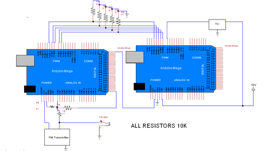

Step 10: Wiring the Transmitter
After all of the components of the transmitter are in place, it is time to connect them all together using hookup wires. Use the above schematic as a reference. My wiring is kind of messy due to the transmitter being a working prototype. The whole transmitter is powered by a 12 volt wall wart, which feeds into the vin of one arduino. The regulated 5 volts is then fed to the other arduino and the regulated 3.3 volts feeds the FM transmitter. Everything will work if you follow the schematic, make sure to get the pin designations right, or the program will not work. Now that all the hardware is built, it is time to write the software.
