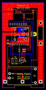

2025 update: as this project proved to be extremely useful a new version was calling for itself. Instead of creating a new Instructable I will just replace the schematics and codes here as there were some issues with the old one, namely:
- The Wemos D1 relay board was badly engineered, although at the beginning all worked, in 2 years of constant operation 80% of the plugs failed, this was due to some components on it died from the back emf, then the relay did not get enough power anymore either to close or open leading to unreliable operation.
- As I described it in the old article using a shield was a bad idea to begin with, therefore the relay circuit is now fully incorporated into this board, if I went so far why not do the same with the ACS712, to make it even better all the current components can be ordered from the LCSC store, basically only your Wemos D1 mini which needs to be bought separately and it can be plugged into the ready made board.
- All the input/outputs were moved to "safe pins" see the explanation later on why.
- All the regular double sided traces were replaced with even thicker copper zones.
- I have removed the extra article about the "Arduino based smart plug" and the SSL support as both turned to be a bad idea

The circuit board is attached and can be easily imported into EasyEDA (you can also order the components to be pick and placed on it, however the exact same ones will not be available too long, you need to chose a similar component when they are not in store eg: another 10k film resistor, the only way to replace these is to delete them from the sketch and add a new one which is in store).

Step 3: Circuit Design
As with other projects I advise against using Transformerless Power Supplies with all of your Arduino/ESP/Raspi projects. Here is a brief explanation of why:
https://hackaday.com/2017/04/04/the-shocking-truth-about-transformerless-power-supplies/
Originally I actually planned to hack the old plugs, leaving the TPS, the button, the relay and the LED in place and de-soldering everything else from the board but I'm glad that I changed my mind about it.
In the circuit I only had one small issue, that the ESP8266 and ESP32 are 3.3V boards, all the pins are also 3.3V rated and NOT 5 volt tolerant however the ACS712 current sensor is: "5.0 V, single supply operation" which means that you don't operate the sensor from 3.3V or not even 4.8V, you operate the thing from precisely 5V otherwise the voltage reference changes and the whole measurement will be incorrect. The solution therefore was to operate the whole circuit from 5V, take the 5V directly to the ACS and the ESP8266 (it has rectifier on board no worries), then put in a small voltage divider to the ACS712 DATA OUTPUT pin which will result a value not exceeding 3V and the AnalogRead mapping 0-1023 will be the similar as what you would get using a regular Arduino with the sensor (in the software section you will see the adjustments I have made including a small correction of reducing the AmpsRMS to get around the same value as my wallplug meter gives me (take it with a grain of salt tho, this is not some thousand dollar current measurement device just another cheapie from China so you can adjust the code for your needs, the hardware does not require modifications). Also stacking up on HLKPM-05 is a good investment since you can just use them in all your Arduino projects.
One common mistake a lot of ESP8266 and ESP32 tutorials about push buttons, leds and interfacing with Arduino modules commit is putting 5V directly to the GPIOs. Just don't! You can consider the 5V pin as the only pin in this circuit where you should be using 5V, it goes into the ESP8266 regulated to 3.3V and from that point use the 3.3V for everything.
The rest of the circuit is straightforward and does not require any explanation. I have doubled the copper both sides and at manufacturing set the thickness of the copper to 2oZ (per side) to be able to handle the max 10A and a 10A MAX rated fuse was also added (not to be cheapskates), I also like to have a spare soft glued safely somewhere in the box for immediate replacement. If an appliance faulty and shorting the mains out, that might break the fuse but will no way ruin the plug.
Just a note, as I managed to blow up some of these standard Arduino relays in the past: regardless that they are rated for 10A these can even withstand max current of 15-16A for shorter time periods, and the ACS 20A so the first thing which will go is the fuse.
The relay shield was meant to be put on top of the Wemos D1 mini, this is not just dangerous since there is a small airgap between the 230V mains and the metal shielding plate of the wifi but in-practical in my build so I have reversed the order and put the relay directly down to my PCB which is soldered into the PCB with DIP female sockets on top of it where the Wemos will slide into. At the relay shield, two out of the three original screw terminals are connected to the board from the 3rd (always connected) the flux was removed and cut out as it would just interfere with the trace going underneath it and we don't need it. On box of the extension board the screw terminal connectors with the high voltage part are hidden, only the USB has a breakout hole.
The whole board can be ordered assembled now as I switched to SMDs. The power supply, RGB led, switch and the extender pins for the Wemos are the only ones not added.
