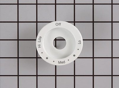

Step 1: Acquire Template Images
If the part you are looking for has a flat area where the letters are printed, you can probably just relabel your existing piece.

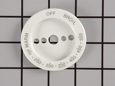

There are a number of websites that sell appliance parts online. They all seem to use the same images to show their stock. If you can find images of the exact item you need, right click on it and save it to your computer.

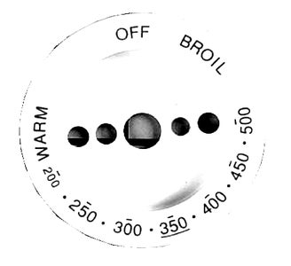

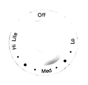

The grid in the background is very helpful. Somewhere on the image it usually tells you the scale (ex. Squares are 1" x 1"). Estimate the length and width of the image and resize it in a photo editor using inches as the units instead of pixels. Convert the image to grayscale and adjust the brightness and contrast all the way up. You want the white parts of the image to be completely white while the black parts are still sharp and completely black. Crop the images down to just what you need to print.
Print these new images on a laser printer. Inkjet printers will not work.
