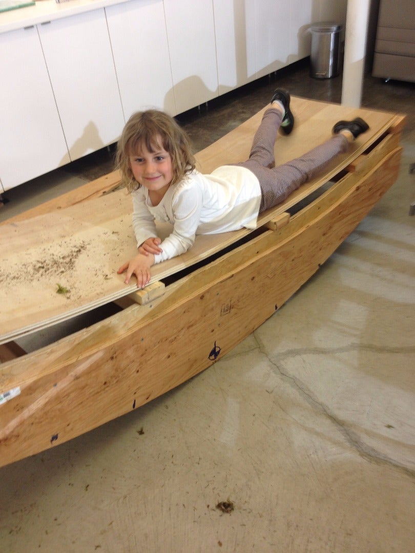

Design should be messy! Sketch, make models, make mock-ups! Test and be open to the happy accident. Use digital tools as necessary when precision is required. We made use of CAD software and digital fabrication to test different curves on the runners.
Step 3: Fabrication
A - Connect two 2x4's to a gusset plate cut from 3/4" ply with a curved bottom
B - Thread 2x4 assembly onto 2 12' long rods
C - Repeat process for 6 runners and space them out at 2' increments
D - Lay three layers of 1/4" ply over runners
E - Spread sod on the top
F - Enjoy!
