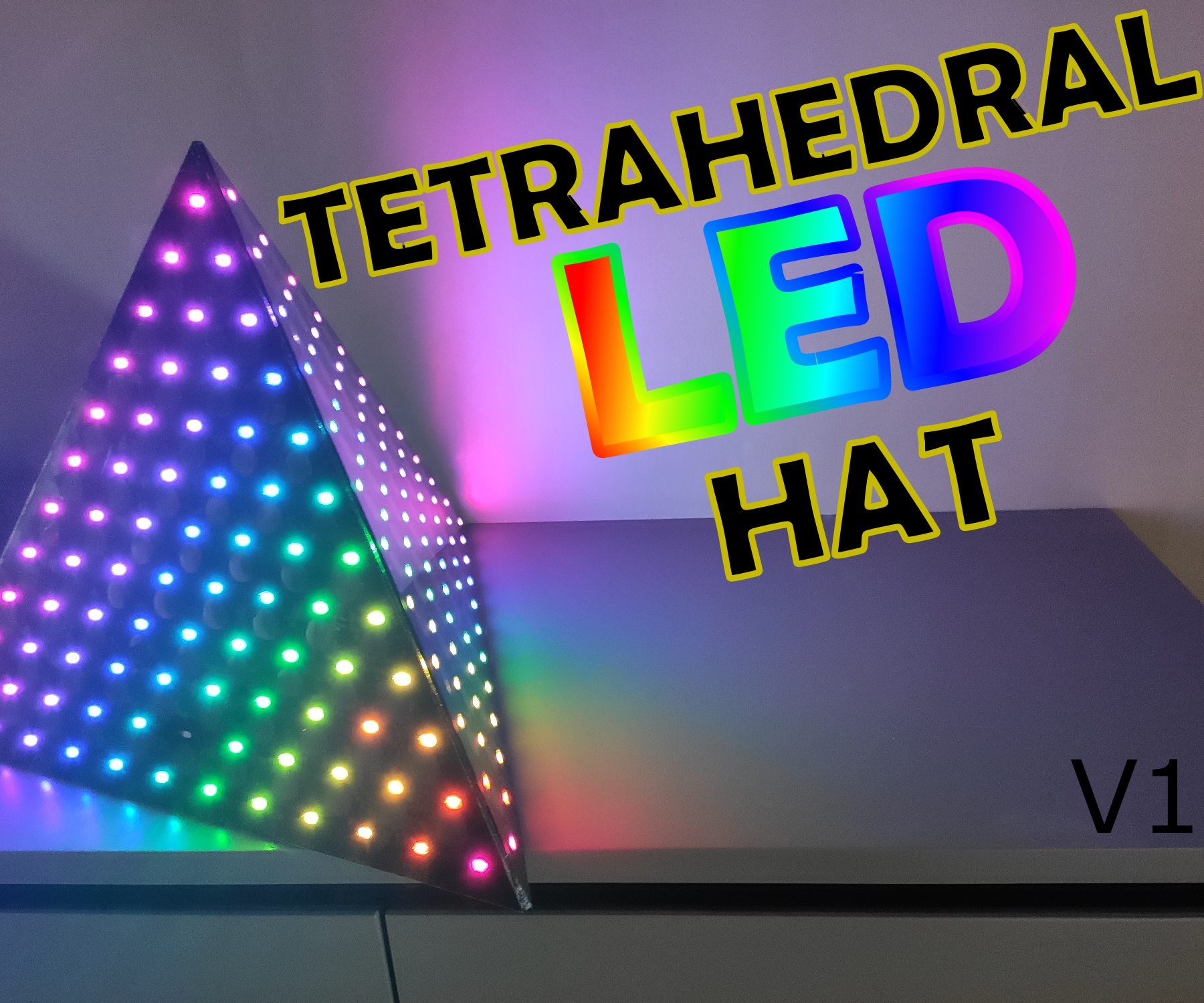

In these days, eveything comes with LEDs on it (even hats, check out my first instruction). It is not hard to add a RGB LED inside the Box, maybe which changes color regulary. So the speaker holes would shine in a nice colored light. For this I would recommend a WS2812B LED with the FastLED.h library for coding it.
