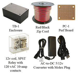

Step 3: Materials
The tools needed are:
Soldering Iron
Solder
Wire Cutters/Strippers
felt tip pen
The materials needed are:
Extension Cord - 12 to 15 feet - get these from anywhere
AllElectronics Enclosure - TB-1 which is 2.7x1.7x1.2" - $1.75
Red/Black Zip Cord - 25 feet, AWG 24 - this cable has both wires bonded together just like the extension cord (looks better than separate Red and Black wires) - $4.40
Perf Board - PC-1, 10 holes per inch - $0.75
Relay - 12vDC, 270 ohm coil - 120v AC, 10 Amps contacts - $2.30
*** this relay only requires 50 mA to keep contacts closed !!
AC to DC Adapter - optional - 110v AC to 12v/5v with molex DC converter - $13

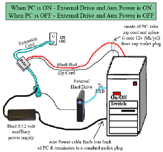

Step 4: Overview
Just to give you a preliminary idea of how it works before you actually start . . . the schematic below says it all. Once you have prepped the relay and wire with solder joints and placed them inside the enclosure, you connect the wires up as shown.

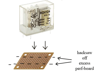

Step 6: The Perf Board (optional)
Perf board can be used or omitted - you CAN solder directly to the pins of the relay !! But mounting it on a small board ford ease the soldering of the connections and protects the bottom of the relay from your solder gun tip and excess heat during soldering.
First insert the relay contacts by feeding them through the holes. Then Mark the edges as an outline on the perf-board with a sharpie or any felt tip pen. Remove the relay, and cut the perf board to size using a hacksaw or shears. Re-insert the relay into the perf-board.

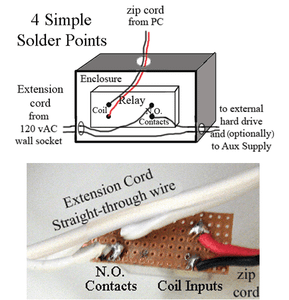

Step 7: Solder the Wires to the Relay
Spread the two wires of the extension cord apart and peel back about an inch. Cut one of the wires and strip the ends. Then make the 4 solder joints as shown.

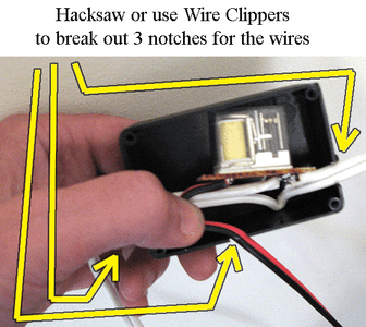

Step 8: Notch the Enclosure and Insert Relay
Remove the 4 screws and take off the top of the enclosure. Then cut 3 notches in the edges of the enclosure as shown - this is holes for the wires to pass through.
DO NOT Drill holes instead !! You will not be able to feed the wire through the holes. No, you need notches.
The plastic is soft, so you can use a hacksaw, a dremel, or even a set of wire clippers to cut two slots and the use pliers to break off the plastic and create the notch. Then insert the relay and screw the cover back on.

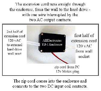

Step 9: Check Your Work
Your Enclosure should now look like this. You might want to plug it into the wall, plug a lamp into the other end, and connect the zip cord to a 12v source or a (9v battery will work) - the lamp should turn ON and it should turn OFF when the voltage is removed from the zip cord.

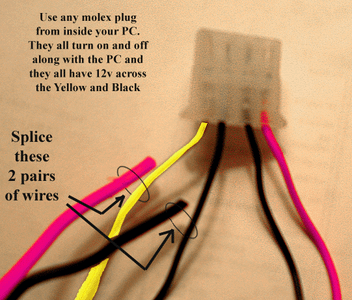

Step 10: Splice the Zip Cord to PC Molex Plug
This is a simple splice - just cut and strip the wires, add some heat shrink tubing, twist them together, solder, and then apply heat to the heat shrink. Alternatively you can use Electrical tape. Do NOT splice Red-to-Red, as that is only 5 volts, and you need 12 volts.
The professional way is to insert a molex adapter called a "Y adapter". It has three plugs and is meant to "Y" off an additional power source. Cut all 4 wires of the Y and to remove the plug. Cut off the excess unused Red and Black molex wires, and splice your zip cord directly to the black and yellow wires on the Y adapter.
Step 11: Connect It All Up and Test !!
Follow the pic below - which is the same one we showed earlier. Plug the extension cable into the wall, plug the hard drive AC wall wart into the end of the extension cable, and plug in the aux PSU if you are using one. Then connect up the Hard Drive and PSU if not already connected. Finally, turn you machine ON and OFF a few times to make sure the relay is kicking in and turning your stuff ON and OFF.
