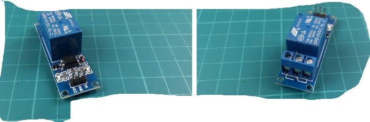

This relay cannot be connected directly to the Arduino board. This is because the high voltage we apply to the relay can cause it to burn out if it returns to the Arduino board. For that, we need to create a small circuit. But for this, we will use the relay module designed for Arduino.
It is designed as a very safe circuit. An optical coupler IC and a diode were used to stop the return of electricity. It includes three pins and three terminals. The VCC and GND pins are used to power this relay module and the IN pin is used to give the signal through the Arduino board. The middle terminal is called a common pin. It must be given an input voltage. The other two terminals can get outputs. The right terminal is NC and the left terminal is NO. The voltage we supply to terminal 3 can be obtained through terminals NO or NC. You must remember the AC voltage is very dangerous. Must be careful working with AC voltage.

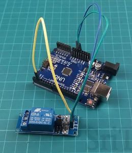

Step 1: Hardware Required
  1. Arduino Uno board x1
  2. Relay module x 1
  3. Jumper wires

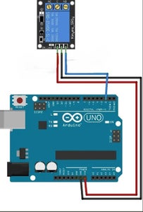

Step 2: Diagrame
Connect these components as follows.

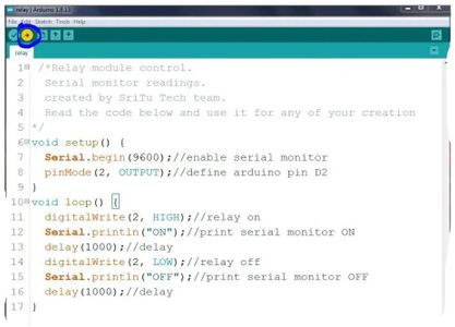

Step 3: Code and Test
Let’s look at the code. This project uses the LED blink example code.
  1. The complete program of this project –
/*Relay module control.
Read the code below and use it for any of your creation
void setup() {
Serial.begin(9600);//enable serial monitor
pinMode(2, OUTPUT);//define arduino pin D2
void loop() {
digitalWrite(2,HIGH);//relay on
Serial.println("ON");//print serial monitor ON
delay(1000);//delay
digitalWrite(2, LOW);//relay off
Serial.println("OFF");//print serial monitor OFF
delay(1000);//delay

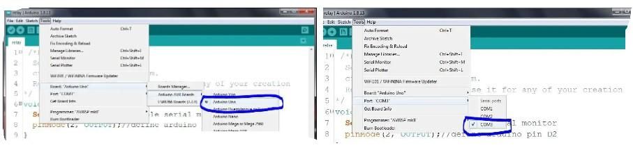

Now, select the board and port. After, click the upload button
OK, now you can test this project. The video below shows how to install an AC bulb in this project. Please try it safely. So we will meet in the next post.
