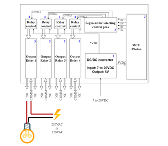

A relay shield is a baseboard device for an electronics platform with a microcontroller like Arduino. It is developed primarily for a Wi-Fi IoT device named Photon from Particle company, but it can be used with other devices with slight modifications of hardware. Following is the description of the block diagram:
  • DC/DC converter: Make sure that input voltage is in range 7 to 20VDC. The converter gives power for MCU and relays control segment which is 5VDC. The maximum converter current is 1.2Amp. Blue indicator is present as an indication for power. Following are the ways to provide power to the device:
  • Terminal block: Maximum current: 6A and Maximum voltage: 125V
  • Power jack
  • MCU Photon: MCU for relays control. The device has physically connected pins D3, D4, D5, D6 to segment for selecting control pins. D3 controls Relay 1, D4 Relay 2, D5 Relay 3, D6 Relay 4. Relay shields can be powered with an MCU cable. Don’t power device with MCU cable and DC/DC converter! It can lead to devise damage. Primarily, PCB is designed for Photon MCU. Maximum logic level voltages are 6.5V (determined from NPN transistor maximum emitter-base voltage)
  • Segment for selecting control pins: Place short jumper to use pins D3, D4, D5, D6 from MCU. For using pins that are not D3,…, D6 remove the short jumper and connect pin from MCU with relay pin using a jumper cable.
  • Relay Control: Segment for the interface between logic pins and relays. A red indicator is present as an indication for the relay state.
  • NPN transistor for activating relay: Maximum collector current: 500mA
  • Flyback relay diode: Maximum DC Reverse voltage: 75V and Maximum forward continuous current: 300mA
  • Output relay: SPDT relay. If the logic pin from MCU is in “logic low” state COMM and NC are connected. If the logic pin from MCU is in the “logic high” state, COMM and NO are connected.
  • SPDT relay: Relay contacts can’t exceed values; Maximum AC load voltage: 250VAC and Maximum DC load voltage: 110VDC Maximum current: 10A

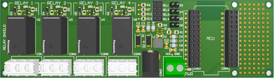

Below is the schematic design of the design which I have designed on Altium Designer. After designing on a software I have uploaded all my design files online on Inventhub for the users, manufacturer, and the component provider. There is no need to visit the manufacturer manually he can download my schematic design from Inventhub. Here you can find my design files on Inventhub.

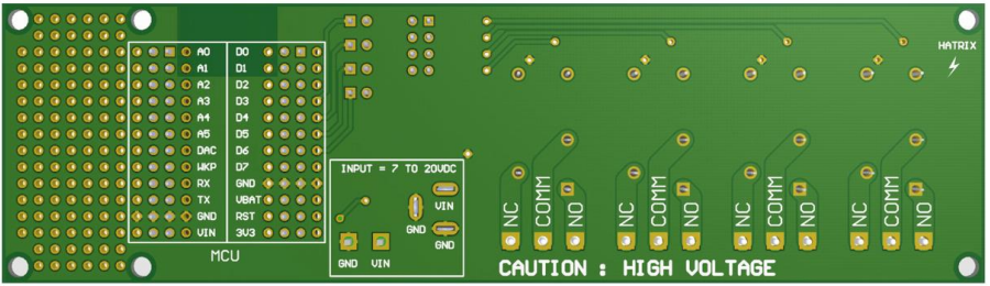

Step 3: PCB Board Design
After designing the schematic, I have converted it into the PCB design. Here I can see the 3D view of my PCB board. For fabrication, I will send the release file of my project to the manufacturer that will be containing all design, PCB, and component files. He will easily export the file and can fabricate the board without any error. This is the link to Inventhub to the release file of my project.
Step 4: Bill of Material (BOM)
At the last stage of designing of PCB board, I have to embed components on the board. For the exact dimensions, and size of the components, I have created a BOM file of my project that contains library reference, part manufacturer, size, dimensions, and footprints. I will send this BOM file to the component provider he will download the file in MS Excel and can view my parts details. My BOM file is available on Inventhub.

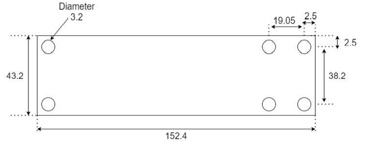

Step 5: PCB Board 3D View and Dimensions
