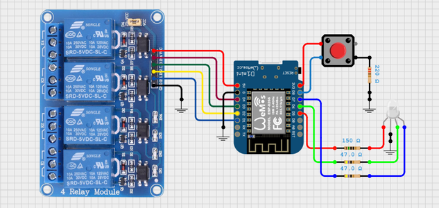

  1. x1 ESP8266 board
  2. x1 Relay Module (depending on the number of devices to be controlled)
  3. x1 RGB LED
  4. x1 Push button
  5. x4 Resistors

Step 2: Flow of Operations
  1. Startup and Configuration: When the device is turned on, it attempts to connect to WiFi and retrieve stored configurations. If there is no data, it enters configuration mode.
  2. Interaction with Telegram Bot: Users can send commands to control relays and configure permissions.
  3. LED alerts: indicate system status in real time.
  4. Notifications: Messages are sent in Telegram when there are important changes or errors.
