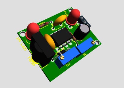

In this particular proximity sensor, we will be generating a constant stream of square wave signal using IC555 centered at 38 kHz and would use it to drive an IR led.
So whenever this signal bounces off the obstacles, the receiver would detect it and change its output. Since the TSOP 1738 module works in the active-low configuration, its output would normally remain high and would go low when it detects the signal (the obstacle).

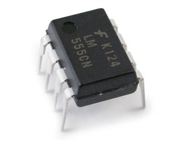

1, 555 ic

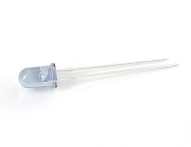

5, LED IR LED,Yellow LED

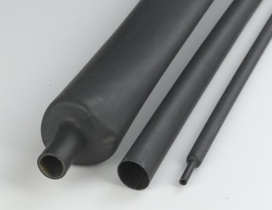

10, heat shrink tube

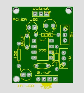

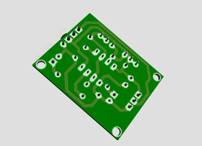

Step 4: PCB Assembling
