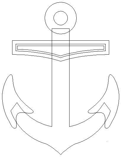

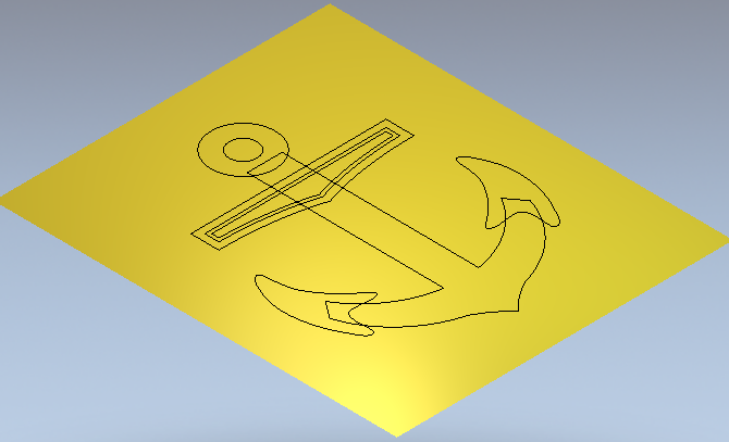

1 Click on the Open Model function in the Start Panel to display the Open dialog box
2 Open the model anchor.art
The vectors are displayed in the 2D view and 3D View.
This tutorial is based in the default ArtCAM function layout. If you have customised your layout and wish to return to the default, from the Window pull down menu choose Reset Layout>Standard
3 Change the 3D View from Top View to Isometric View ![]()
The vectors are displayed on the 3D View.

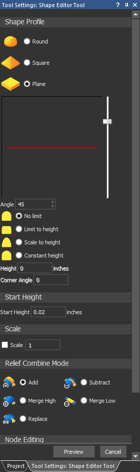

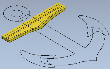

4 Double left mouse click on the vector shown below to open the Shape Editor form
5 Select a Plane shape with a Start Height of 0.5 mm(0.02”)
For a Plane, The Start Height indicates the very top Z level.
6 Set the Combine Mode to Add
7 Click the Apply button to generate the shape
8 Click the Cancel button

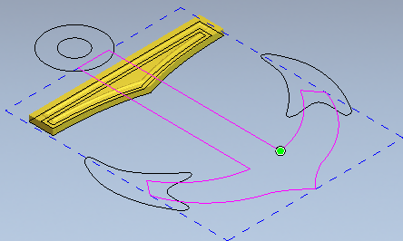

9 From the 3D view toolbar, click on Draw Zero Plane
to hide the Z zero plane
The bar is produced as shown. If you place the mouse on the Relief, the Z height at that point 0.5mm (0.02”) will be displayed in the information box at the lower right of the graphics area.

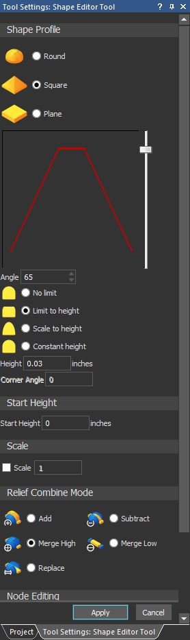

12 Press F12 on the keyboard to open the Shape Editor form
13 Select a Round shape with an Angle of 45 degrees and No Limit with regard to overall height
14 Enter a Start Height value of 0(0”)
15 Click the Apply Button

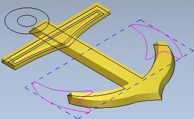

The main body of the Anchor will now be created and merged into the current Relief.

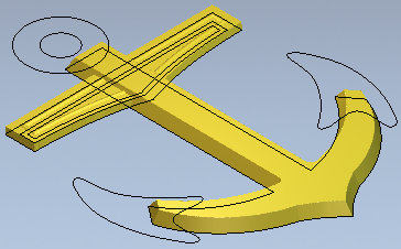

17 Select the main anchor vector as shown highlighted
18 Press F12 on the keyboard to open the Shape Editor form
19 Select a Square shape with an Angle of 65 degrees
20 Select Limit to Height and Enter a value of 0.75mm (0.03”)
21 Click the Merge High box and Apply
22 Click the Cancel button
The main anchor shape is created and merged with the bar relief.
This shape was produced from the vectors extruding as a triangular shape of 65 degrees. As it reached a height of 0.65mm, it ‘levelled off’.
23 Shift Select the two hook vectors as shown
24 Press F12 on the keyboard to open the Shape Editor form
25 Select a Round shape with an Angle of 30 degrees
26 Enter a Start Height value of 0.75mm (0.03”)
27 Click the Merge High box and Apply
28 Click the Cancel button
The ‘hook shapes’ have been created and merged with the main body.

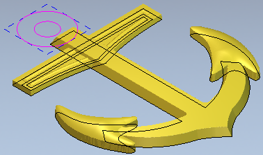

29 Shift Select the two Circle vectors as shown
30 Press F12 on the keyboard to open the Shape Editor form
31 Select a Round shape with an Angle of 65 degrees.
32 Enter a Start Height value of 0.5 mm (0.02”)
33 Click on Merge High box and Apply
34 Click the Cancel button

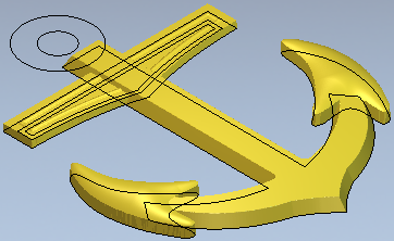

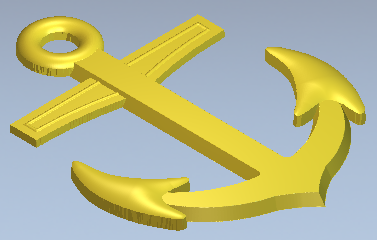

35 From the 3D View toolbar, click on Toggle Vector Visibility![]()
The Vectors are hidden, and the final result can be seen clearly.

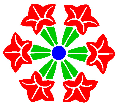

The following tutorials demonstrate the creation of a basic relief from bitmap colors.

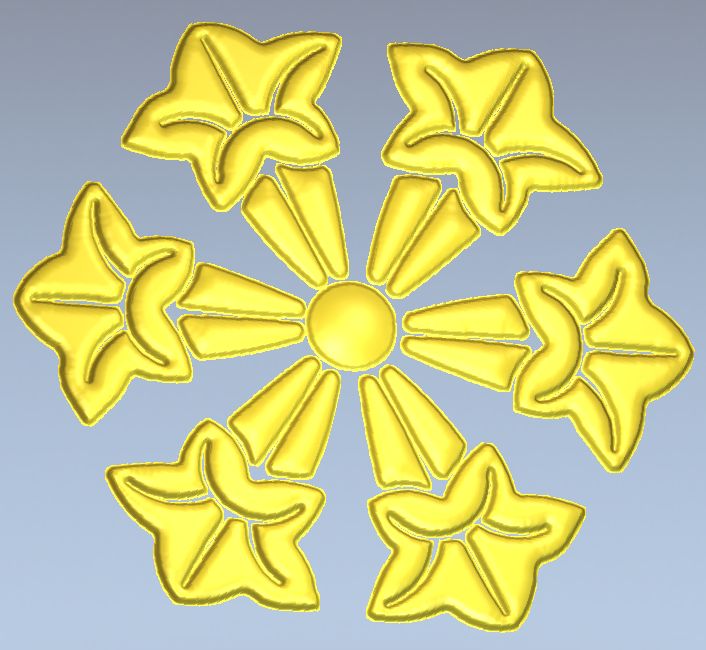

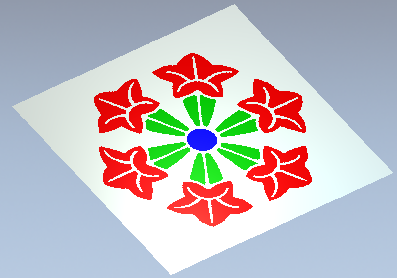

1 Open BitmapMotif.art
2 Switch to 3D View
3 Toggle on Display Bitmap icon from the 3D View toolbar ![]()
4 Double click on the colour blue directly to open the Shape Editor
- Choose a Round shape with an angle of 30 degrees
- Enter in a Start Height of 1mm(0.05”)
- Check Scale To Height and type in a Height of 3.5mm(0.15”)
- Click Apply and Cancel

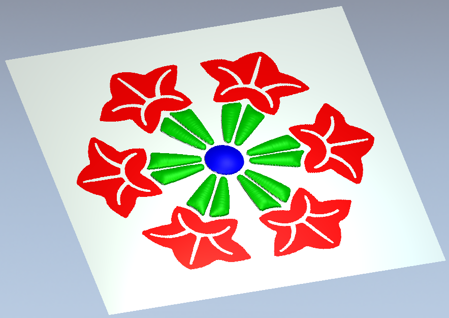

5 Double click on the colour green to open the Shape Editor
- Enter in a Start Height of 1.5mm(0.1”)
6 Double click on the colour red to open the Shape Editor
- Choose a Round shape with an angle of 40 degrees
- Enter in a Start Height of 2mm(0.1”)
- Check Limit To Height and type in a Height of 2mm(0.1”)

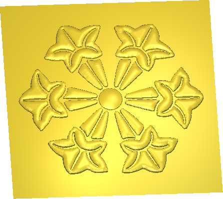

7 Select Display Material
to toggle back to the Relief (material) view.
8 Select Smooth Relief
from the Relief Editing Toolbar
- Apply 3 smoothing passes and close the form
9 Toggle Zero plane
from the 3D view Toolbar to view the results.
