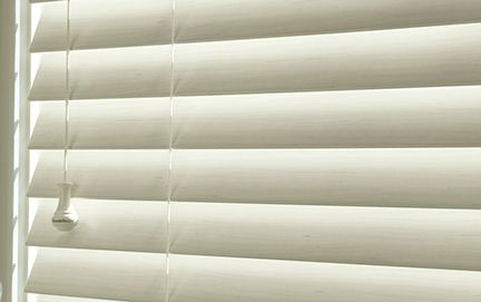

Have you noticed that the shadows on blinds can make a grayscale gradient? I have. And if you’re anything like me, you get excited whenever you see a naturally occurring gradient.
I realized that if you could control the shape of each blind, you could control the grayscale value along the strip. The more shallow the strip, the less shadow, and the brighter the value. The deeper the strip, the more shadow, and the darker the value. By shaping each strip to match the intensity values of a given image, you can reproduce that image in shadow, without painting, printing, or any pigment at all.
