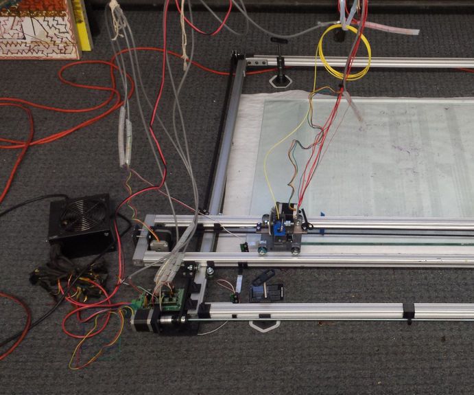

Here pictured is the second version of my large-format RepRap-oriented, Arduino-based, 3D printer, paintstruder, and plotter built from scratch in 2016. Printable / plottable area is almost 3 feet. Printable Z-height is around an inch, so while having X/Y dimensions similar to a BigRep, its Z is relief-sculptural, hence "ReliefRep". 80/20 aluminum extrusion is used for the frame and all connective parts were 3D printed on my other bots. The whole printer mounts to a tabletop or workbench. A 1/4 inch sheet of glass serves as the printbed. Disclaimer: this Instructable isn't so much a step-by-step "how-to" as it is an example of make-shift making meant to inspire similar strategies.
Step 1: Electronics and Y-axis
Power supply, RepRap Arduino MEGA Pololu Shield (RAMPS), Y-axis motor and shaft system.
