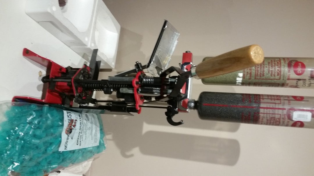

This is a great instructable to learn how to refill once fire shotgun shells. This specific instructable is made using a 12 gauge rounds, however the same methods apply to other gauges in different proportions. The reloading press used in this one was a MEC 9000G. There are many other machines out there to do this process that will follow similar steps if you have one of these, and need advice please post a comment of your machine name. I'll try to help you.

For this particular load i'll be using a Mec #32 bushing for powder and 7/8 oz of lead charge bar.
1 oz wads that are of the AA variationD.
Step 2: Check the Machine for Components

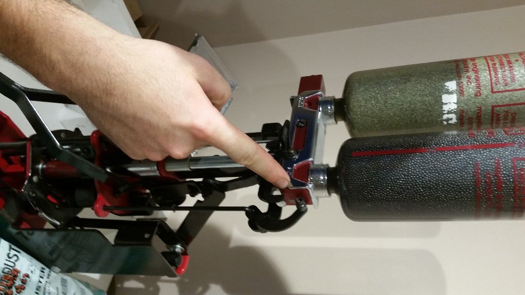

Check the priming station to verify there are enough primers to load the amount of rounds you want to load. If there is not enough add more to the try.
Check the powder and shot tanks to verify they are the proper size shot, proper powder, and have enough contents to reload the amount of rounds you wish to run. DD

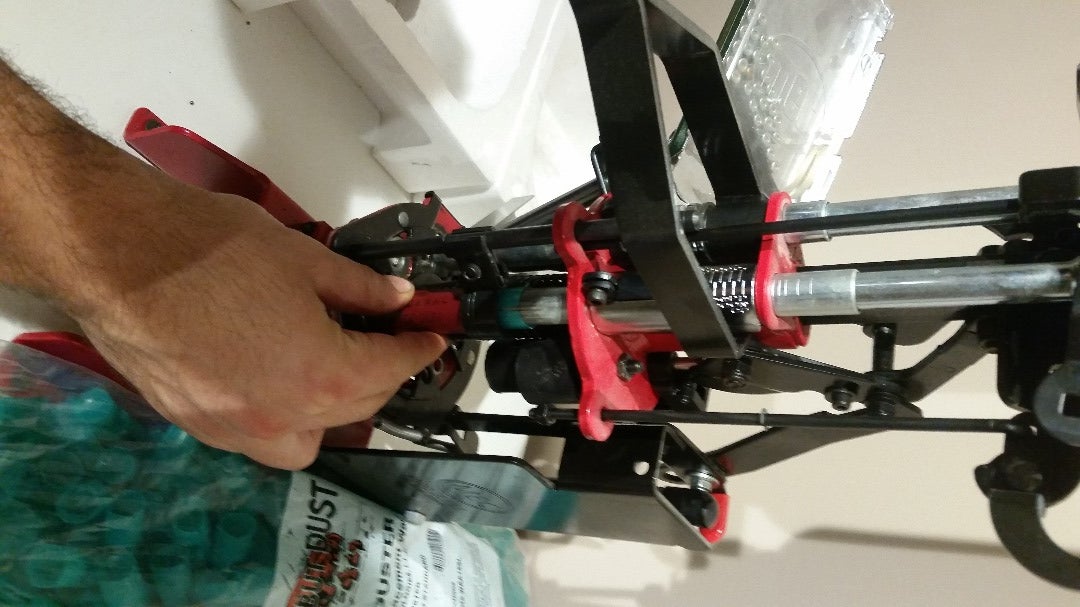

Step 3: De-prime the Empty Round
Add an empty shell to the first station of the reloader and depress the handle. You should feel resistance as the machine presses out the spent primer. Allow the handle to left under the pressure of the spring. The shell should automatically index on this machine to the next station. Ensure the a fresh primer drops into the reprime station before the case indexes above it.
Step 4: Re-prime Your Round
If you want to continue to load rounds with the progressive press feature add a fresh empty round each time the handle is depressed. Otherwise you can run one round at a time by waiting for one to be complete.
Depress the handle until it is in the full down position. On the down stroke the machine will press in a new primer. On the upstroke the machine will drop a pre-measured powder charge into the round. Verify the charge bar has moved positions upon the completion of the upstroke. The case will index to the next station, and you will now have a round that has a new primer and powder in it.
Step 5: Add the Shot
Take a AA wad out of the bag and set it on the wad guide of the machine. Press the handle down all the way. The wad will be pushed into the round. On the upstroke the machine will drop a charge of shot into the wad. You should hear the shot drop, also verify the charge bar has now returned to its previous position. Upon the completion of the upstroke the shell will index to the next station. P

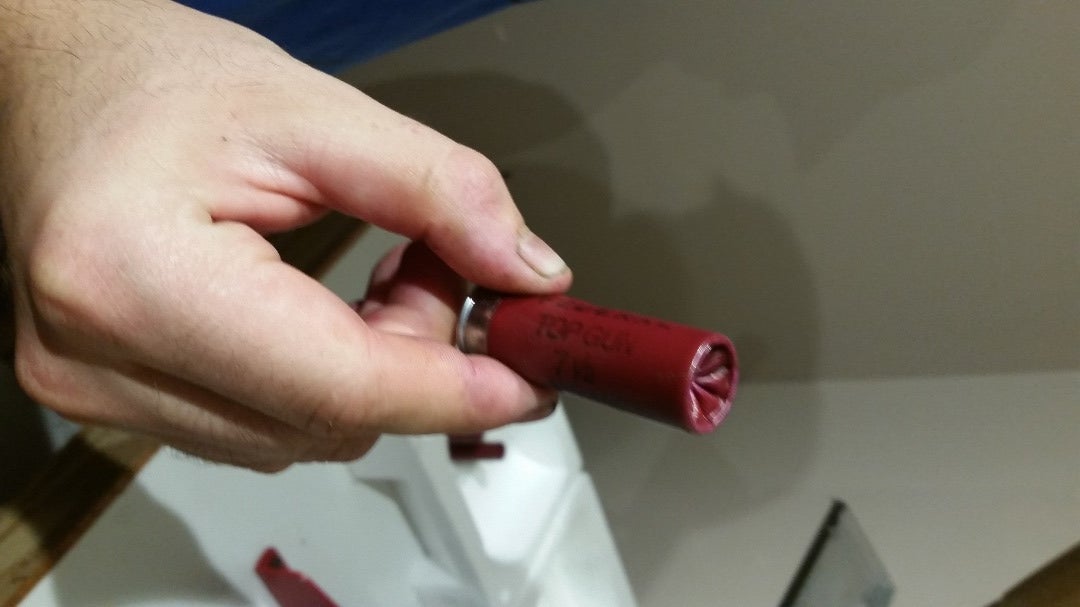

Step 6: Pre-Crimp
In this station the crime will be started. Push the handle all the way and then bring up. The shell top will be half way closed at this point. It will then index to the next round. FF
Step 7: Finish the Crimp and Discharge
Pushing down on the handle at this section will close the crimp the rest of the way. Upon the upstroke the shell will be ejected from the machine.
Step 8: Enjoy
The round is now complete and ready to fire. Always perform a visual inspection to verify no defects.
