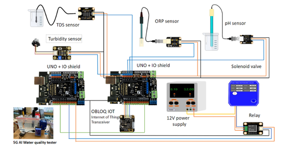

Step 2: Reused the Components of the AI 5G Water Filter System
The UNO with the IO shield, relays and DuPont wires could be reused to make the new project, which was used in the project of "https://www.instructables.com/5G-AI-Water-Filter-System/" in the first-time author contest.

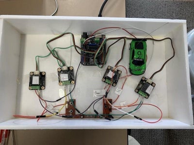

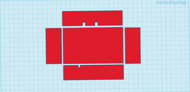

Step 3: Design of the Box Holding the Circuit
The box holding the circuit was designed by using Tinkercad. The three holes in the box, allowed the wires to pass through. Two holes were for the UNO and the other for the transceiver of the remote control of the mini car.
Step 4: Product of the Box
The box was made of old foam boards. Three holes:
  1. One for the charging wire of the mini-car
  2. One for the USB cable of UNO
  3. One for the power cable of UNO

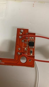

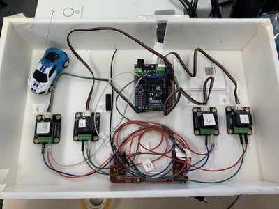

Step 5: Re-Design the Radio Control Circuit
Reused the UNO with the IO shield, the relay and the transceiver of the wireless car. We remade the transceiver by connecting the wires from UNO. Four control buttons in the remote of the wireless RC car were connected to four relays which could be controlled by UNO that the wireless cars could move forward, move backward, turn left and turn right. The soldering process were done.
Step 6: Re-Soldering the Circuit
Remade the circuit in the RC car. The RC transceiver was connected with four digital relays. So, the UNO could control the RC car by writing python programs or block programs. Two cars (27Mhz and 40 MHz) and two RC transceivers (27Mhz and 40 MHz) were remade since two players could play together.
Step 7: Testing the Redesigned Radio Communication Circuit!
The UNO pin 9, pin 10, pin 11 and pin 12 controlled the wireless car to move forward, move backward, turn left and turn right. The video showed that the wireless RC car moved forward and turned left, and moved backward and turned right. We controlled the wireless RC car to move more precisely, which was one of the improvements, by programming.

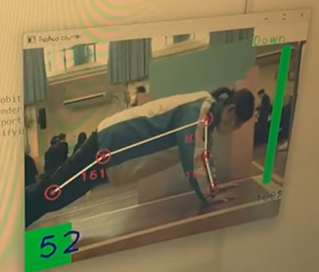

Step 8: Re-Code the Python Program
We learnt how to write Python with google mediapipe library. Rewrote the python program, which was inspired by learning the website of Aryan Vij . We rewrote the python code by adding the initialisation of UNO and adding the control code of D9 and D11 to call the wireless car turning left and moving forward. The bold and italics codes was added and modified. Remade it again to meet our requirements. Push-up could drive the car to turn left and to move forward. Mediapipe and AI programs were applied to this system, which was the improvement of the single purpose of playing the RC car or the single purpose of doing push-ups.
The python program was below:

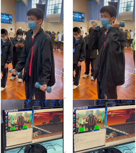

Doing "Bicep curl" to drive the hot fire. Firstly, we did the initialization in the program. We added the pyautogui library into the python program.  The bold and italics codes were added and modified. Students not only did "Bicep curls" but also played video games. All these features were the enhancement of the activity.

stop = 4 #4d : four hot fire!
Step 10: Modify the Codes to Detect the Movement of the Left Hands and the Movement of the Right Hands
   The bold and italics codes was added and modified. Sending the character "d" to control the scratch game to give the hot fire.

Step 11: Push-Up = Drive the Car. Amazing!!!
The Video showed that doing push-up could drive the RC car to move.
The boy did the push up.
https://youtu.be/gg_6U7yvDP8
In the STEAM week, more students liked doing the push-ups rather than in the PE lesson.
Step 12: Bicep-Curl = Hot Fire. Terrific
The video showed that doing bicep curls could drive the street fighter to give the hot fire.
The teacher did the bicep curl.
https://youtube.com/shorts/mPqHURSTFSs?feature=share
The girl did the bicep curl.
https://youtube.com/shorts/WSQzZjlousI?feature=share
In the STEAM week, many students and teachers liked doing bicep curls.
Step 13: Students Enjoyed to Do the Exercises.
More than a hundred students played the AI sports games and did the exercises.

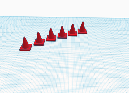

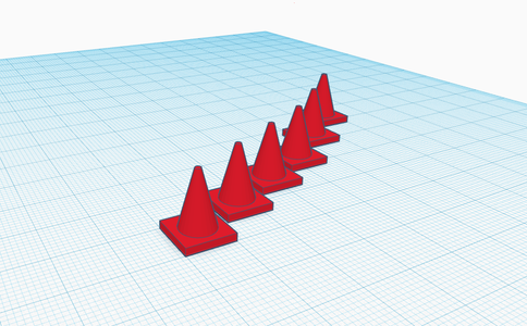

Step 17: Traffic Safety Cones
We used the Tinkercad to design the traffic safety cones and 3D print them.

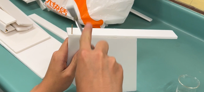

Step 18: Remake the Foam Board to Build the Race Track
After the STEAM week, we built the race track by reusing the unused foam boards. The foam boards could be obtained since many decorations were made on the School Information Day. We used toothpicks and glue to assemble the rack track parts. Since the impact of the racing car is large, both toothpicks and glue could provide the solid anti-collision structure. The race track could be decomposed into smaller pieces for storage. In addition, the race track could be transformed. The foam boards were priceless. After the remade process, the value was added to the unused foam boards.
Step 19: Assembly the Race Track
We divided the race track into different parts and assembled the race track.
Step 20: The Product of Race Track
We reassembled the race track in a different format. The clips were used to connect all the parts.
