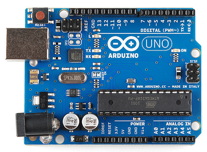

Arduino Uno (or compatible board) , 1, Main controller

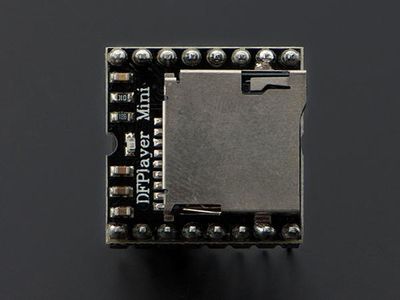

DFPlayer Mini MP3 Module, 1, For playing voice guides
Micro SD Card (FAT32 formatted), 1, For storing MP3 files

Wire DFPlayer to Arduino (RX/TX via pins 10/11).
Connect buttons to pins 2–9 with GND pull-ups.

Components: Arduino Uno board and DFPlayer Mini. For more details on the MP3 player, refer to DFRobot's product page.
