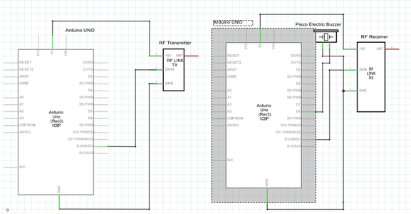

Step 2: Wiring Scheme
Here is the schematic diagram of overall invention.

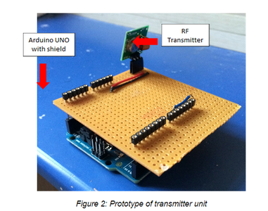

Step 3: Hardware for RF Transmission Module
To be convenient, create an Arduino shield by using the stripboard. As you can see in the pictures, I solder a female header each for the RF transmitter and receiver as well as the Piezo electric buzzer. By doing that, a faulty unit can be easily plug out and replaced without the need of de-soldering. On top of that, I have added a molex header to interface the piezo electric buzzer and the bracelet with the receiver shield.

The transmitter unit which is made up of an Arduino UNO and a RF transmitter is placed at bus stops along the bus routes. (Refer to Figure 2). The RF transmitter will then transmit the identification number of the bus stop. The data will be captured by the RF receiver and data will be processed by the receiver unit. (Refer to Figure 3). The receiver will check if the bus stop number from transmitter unit matches that of the user’s data. If the bus stop number match, the piezoelectric buzzer at the receiver end will produce a sound to wake the user up.
