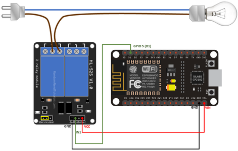

Step 3: Connecting a Relay Module to the ESP8266 NodeMCU Board
Follow the diagram below to wire the relay module to the ESP8266. The diagram illustrates the connection for a 2-channel relay module; wiring for a different number of channels follows a similar pattern.
Alternatively, you can utilize a 12V power source to operate 12V appliances.
In this instance, we’re controlling a lamp. Since we only intend to illuminate the lamp occasionally, it’s preferable to employ a normally open configuration.
We’re linking the IN1 pin to GPIO 5, though any other suitable GPIO can be utilized. Refer to the ESP8266 GPIO Reference Guide for more options.
Step 4: Controlling a Relay Module With the ESP8266 NodeMCU – Arduino Sketch
The code for managing a relay with the ESP8266 is as straightforward as handling an LED or any other output. In this example, since we’re utilizing a normally open configuration, we must transmit a LOW signal to enable current flow and a HIGH signal to halt it.
The following code will illuminate your lamp for 10 seconds and then deactivate it for another 10 seconds.
