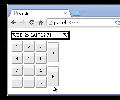

Remote Status View
When you browse to the device - there are Green Leds that show all is ok - they can be configured to change Red if there is a problem. Hooking these to the alarm ouputs of the Alarm Panel will let you see the Arm Status of the alarm remotely. Note: you must use a mechanical relay or opto isolator (circuit on next step) or something similar between the Alarm Panel and the Arduino as the Alarm outputs can be 12v-14v and the Arduino can only accept 5v max.

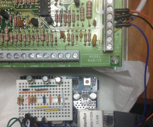

The build is fairly straightforward. I had to solder wires to the DC-DC power supply and as I was monitoring the printer output, I had to solder a chip to invert the signal - more on that below.
Hardware
I used an Arduino UNO with an Ethernet shield.
These are available from many places - shop around the prices vary greatly. Amazon is a good source.
You can either buy the Genuine version, or as the manufactures are open source and allow third parties to make their own versions - these clones will work also and you can get both for under $10 each.
For the power - you need 5V - I used a DC to DC converter from Ebay - these are really cheap (Aprox $3 to $4) and provide a stable 5V from the Alarm Panels 12V External output supply - without getting hot. Very efficient.
Do not try power the Arduino from the Alarm Panels 5V supply. I prefer not to use the built in 9V DC input of the Arduino as the onboard 9v to 5v stepdown regulator is very inefficient and makes the Arduino get really hot - especially when using the Ethernet shield.
If your alarm supports it and you are building the Printer Monitor (to capture the Event Log) you will need some way of converting the alarm panels RS232 voltage level to the Arduino RX/TX TTL level or 5V.
My Alarm Panel (Aritech) - the voltage was correct (0..5V) but was Inverted to what the Arduino expected - It wasn't reliable enough to do in software, so I used a Hex Inverter chip (see photo) to invert the TX from the panel. I used a chip that had 8 inverters only because that's what I had in my spare part bin. Consult the pinout for the chip you use. You will need supply the chip with +5 and GND as well as the signal input from the panel and output from the chip to the Arduino RX pin.
The Photo shows the Hex Inverter chip and Also the DC-DC (12v to 5v) power supply.

The Buttons on the HTML page control the Arduino Digital Pins (see the code for the pinouts). All the Alarms I have seen allow you to designate a zone input as a "Key switch".
This is normally something you can wire to a device - like a physical key you need insert and turn to arm and disarm the alarm - We can use this input to control Arming and Disarming from the Aruino. I have included the circuit for this in the photos above.
On my panels - there is an Output - a High (12V) means the Alarm is Set, a Low (0v) means the Alarm is disarmed. These are fed into the Arduino (using a relay).
The HTML pages delivered will show the status of this input. You could also connect to any LED the system might have to indicate the Alarm is set. Conclusion With some tweaking - this should allow you to monitor and arm/disarm any alarm panel - from any remote web enabled device - such as a mobile phone.
