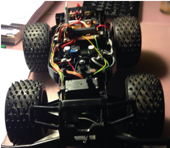

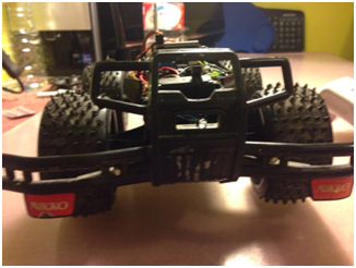

· Car Chassis
· DC Motors

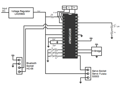

Step 1: Components Interconnected
In the picture that we can see up, there is a block diagram with the different components of the design interconnected between them.

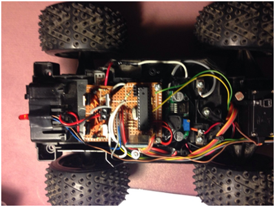

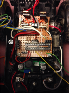

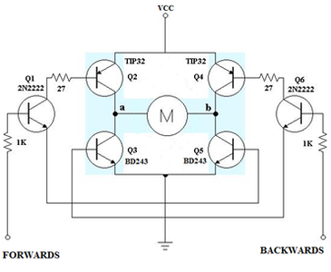

Step 2: H Bridge

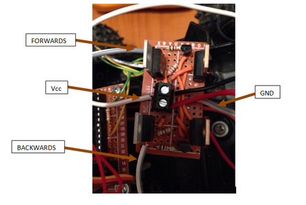

The H Bridge is necessary because it is what allows a motor to run forwards/backwards. To create this device we have used two BD243 transistors, two TIP32C transistors and two 2N2222 transistors besides two 1kΩ and two 27Ω resistors. This components were interconnected like the diagram shows above.
The sheet finished is like the picture where black and red wires are the points 'a' and 'b' of the motor in the previous diagram and the different signals are marked.

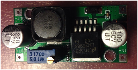

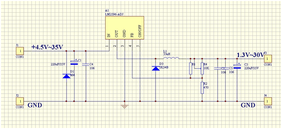

Step 3: Voltage Regulator
We have used a LM2596S Voltage Regulator with the schematic above.
We could find a PCB which we could buy. This module should be regulated for the 5V voltage in which the circuit worked. For this it uses a potenciometer.
Step 4: Bluetooth Module HC-06
This device implements a Virtual UART in which like master has a bidirectional communication with the microcontroller.
Step 5: Servo
We are used a S3003 servo. This one is used for the steering and it is connected to the 15 pin of the microcontroller.

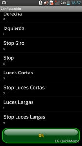

Step 8: App
We have used an application called MOBOT BTCar (avaliable in Play Store). This app sends different kinds of commands by Bluetooth depending on the movements of the car or the ligth chosen. With the purpose that we can use the code mentioned before we need to introduce the same movements codes in the application.
