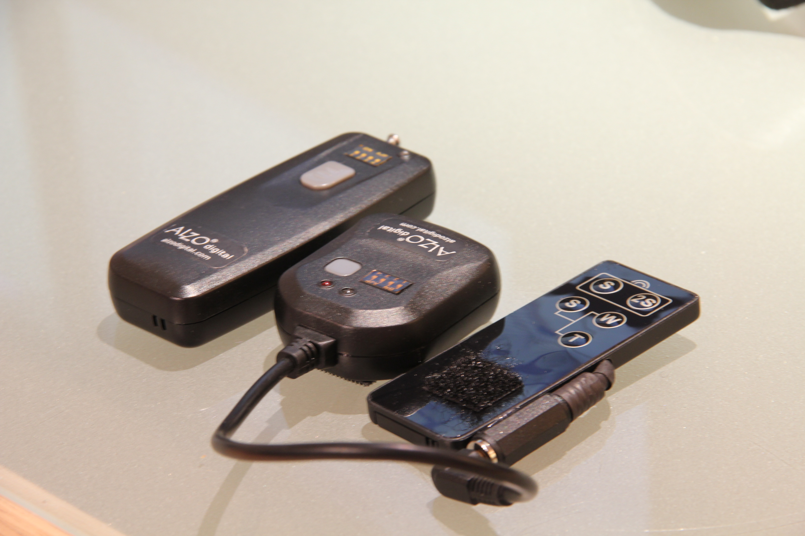

I had a problem that I needed to solve:
Remotely and wirelessly trigger the video recording on my Canon 60D DSLR camera, non-line of sight, from further than an IR remote would allow.
This would eliminate a lot of dead footage when shooting solo or when you want to be in the shot with other people.
As anyone who has looked into this knows, there are NO commercially available systems (or even really any hacked together non-commercial systems that I could find) available for doing this. Still pictures, no problem, but Canon doesn't have a way to do that for video without an IR remote (which is about 10ft, line of sight range). I looked into what I had (both materials and skillset), and decided on building a solution. This should work on any Canon DSLR that shoots video (T2i, T3i, 60d, 7d, 5d Mk2) but I have only tested it on my camera.
My solution uses an atmega328 chip on proto board (basically just a scratch built Arduino), a commercially available RF photo trigger and an IR LED to trigger the camera to record.
The basics of the solution are this:
1: The commercial RF shutter trigger sends a signal to take a photo, which the Arduino reads (as a state change on the input pin).
2: The Arduino triggers the IR LED in a sequence which tells the camera (thru it's IR receiver) to take a video.
3: The control box beeps once to provide an audible alert that recording has fired off, and the power LED starts blinking
4: When the RF trigger button is pushed again to stop recording, the same sequence happens again, except the box beeps twice, and the power LED stops flashing and returns to solid.
Now I have a trigger which will allow me to start video recording from at least 150ft away (the RF trigger claims 300ft, but I have only tested it out to 150ft so far).

I took the RF receiver and added a velcro square to the back of it, and to the top of the case so it would not be flopping around.

Step 5: Use, Conclusion, Improvements
Here is how to set it all up:
1. Plug the RF remote shutter trigger into the 2.5mm input jack on your project box
2. Power on the RF remote receiver
3. Power on the project box
4. Point the IR LED at the IR Receiver on your camera (mine is on the hand grip right below the shutter release button)
5. Turn your Canon DSLR on, and over to video mode (I would also suggest setting your camera "Auto power off" to longer than 1 minute, especially if it takes you a couple minutes to get into position for your shot)
6. Set your Drive mode to be Remote (either 10 seconds or 2 seconds, it doesn't matter), it has to be in this mode to receive the IR signal.
7. Shoot away.
Conclusion:
I am very happy with how this project turned out, and I am looking forward to getting a lot of use out of it. I have been shooting mountain bike and outdoor stuff with my camera, so it's nice to be able to ride in the shot you are taking.
Possible improvements/enhancements to the project:
- Integrate the RF trigger directly into the project so as not to have a separate piece. Although, the advantage of having it separate is so you can use the RF shutter trigger for its intended purpose if you don't want to shoot video, just stills.
- Make the power LED pin a PWM pin and do a nice smooth fade up and down when blinking the LED (didn't think of this one until I was done)
- Add a photo sensor to detect when the camera enters/exits record mode (it flashes the AF illuminator on the front of the camera when this happens). This would fail-safe the process a bit, in case your IR LED wasn't triggering the video for some reason.
- Custom PCB for much simpler assembly than on a proto board.
- Smaller piezo buzzer, installed inside the case
- Louder piezo buzzer
- Rechargeable battery
- Sound/Sensor triggering (this is getting slightly out of scope for this project tho)
