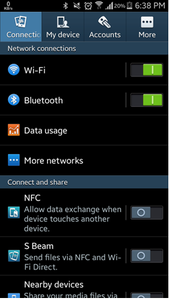

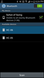

In order to setup the car and its functionalities, a Bluetooth HC-06 module was used. After that, it was paired to an Android phone in order for the car to be controlled. To pair the phone with the HC-06, the following process was followed.

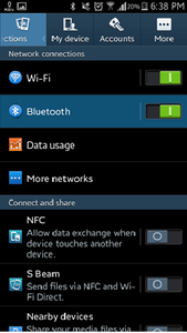

1. Bluetooth is activated.
2. The user Access to the settings.
3. The user selects Bluetooth.

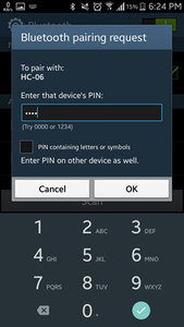

4. The Scan button is pressed. The phone will search for available devices. After the HC-06 module is found, the shall select it.
5. The user shall enter the HC-06’s PIN. The default PIN is “1234”. Once it is entered, click on OK.

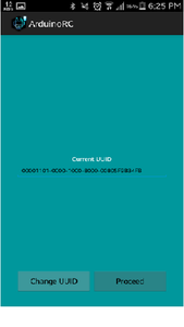

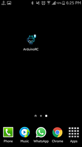

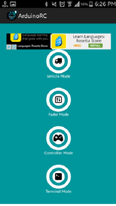

In order to control the car, the program ArduinoRC was used to embed the code from the Arduino to the Bluetooth.
6. Once the device it is paired, we proceed to open the ArduinoRC app.
7. We press Proceed.

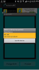

8. The HC-06 module is selected.
9. The Controller mode is selected.

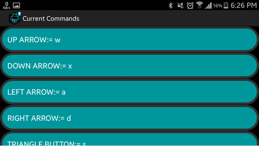

10. Once inside the interface, the user shall press the menu button from the phone. Once opened, Set Commands it is selected.

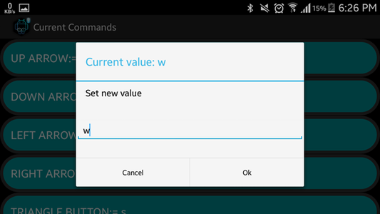

11. Once in the settings, it is needed to setup the letters that were assigned in the Arduino code.
12. The user defines the value and presses ok after each value.
After all the commands from the Arduino code are assigned, the user presses the back button from the phone. The app will now control the car.

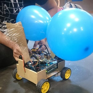

Step 3: Results
As a result of the project we obtained a car made by 4 engines for the rims and two servos that mobilized the weapon used to burst the globes. The car was monitored by a bluetooth controlled by a cellphone and programmed in Arduino. A bluetooth was programmed to control the car and other one to move the weapon to easily burst the globes.
