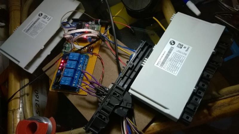

Welcome to a project of mine that has been in the works for a while. In this Instructable, I'll try to give you an idea of what I did to start my car using Bluetooth. First off, here is video to show what I have been able to accomplish.
Since I took this video, I have been able to put the Arduino chip onto its own board and fit everything into the little black box. I also bought a Bluetooth dongle for my computer so the range is significantly better.
In this Instructable, I'll do my best to step through the whole process I went through for this project.

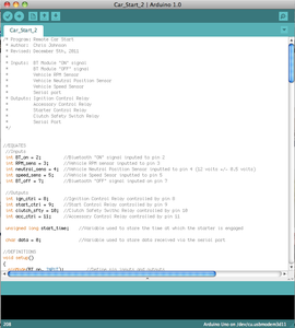

Step 5: Arduino Code
Probably the most intimidating step for me in this whole process was writing the Arduino Code. As I mentioned earlier, this code writing stuff was all new to me. However, it went pretty quick with the flowchart in hand.
You'll notice in the first part of the code that two different signals can be used to initiate the car start command:
1) Sending an "s" to the Arduino via the bluetooth module (which is acting as a serial port) can be used to initiate the starting sequence. This is used when starting the vehicle from a terminal on a computer.
2) Setting a pin on the Arduino high will also initiate the starting sequence. This input pin on the Arduino is connected to the Bluetooth board. When using the Daisy On/Off app from an Android phone, the app will cause the pin on the Bluetooth board to be set high, which in turn will be seen by the Arduino and cause the starting sequence to begin.
Here is my code:
/* Program: Remote Car Start
* Author: Chris Johnson
* Revised: December 5th, 2011
* Inputs: BT Module "ON" signal
* BT Module "OFF" signal
* Vehicle RPM Sensor
* Vehicle Neutral Position Sensor
* Vehicle Speed Sensor
* Serial port
* Outputs: Ignition Control Relay
* Accessory Control Relay
* Starter Control Relay
* Clutch Safety Switch Relay
* Serial Port
//EQUATES
//Inputs
int BT_on = 2; //Bluetooth "ON" signal inputed to pin 2
int RPM_sens = 3; //Vehicle RPM sensor inputted to pin 3
int neutral_sens = 4; //Vehicle Neutral Position Sensor inputted to pin 4 (12 volts +/- 0.5 volts)
int speed_sens = 5; //Vehicle Speed Sesor inputted to pin 5
int BT_off = 7; //Bluetooth "OFF" signal inputed on pin 7
//Outputs
int ign_ctrl = 8; //Ignition Control Relay controlled by pin 8
int start_ctrl = 9; //Start Control Relay controlled by pin 9
int clutch_sfty = 10; //Clutch Safety Swithc Relay controlled by pin 10
int acc_ctrl = 11; //Accessory Control Relay controlled by pin 11
unsigned long start_time; //Variable used to store the time at which the starter is engaged
char data = 0; //Variable used to store data received via the serial port
//DEFINITIONS
void setup()
pinMode(BT_on, INPUT); //Define pin inputs and outputs
pinMode(RPM_sens, INPUT);
pinMode(neutral_sens, INPUT);
pinMode(speed_sens, INPUT);
pinMode(BT_off, INPUT);
pinMode(ign_ctrl, OUTPUT);
pinMode(start_ctrl, OUTPUT);
pinMode(clutch_sfty, OUTPUT);
pinMode(acc_ctrl, OUTPUT);
Serial.begin(9600); //Initialize the serial port with a baud rate of 9600
//PROGRAM
//Loop function: Wait for a START command to be received (command via serial port or
//voltage applied to BT_on pin)
void loop()
if (Serial.available() > 0) //Check if any serial data is available
data = Serial.read(); //Set "data" variable to currently available serial data
check(); //Go to "check" funtion if serial data is available
else if (digitalRead(BT_on) == HIGH) //Check if BT Module has set pin high
begin(); //Begin start sequence if pin is high
else
loop(); //Repeat this function until a START command is received
//Check function: Test for proper character set from BT
void check()
if (data == 's') //Check if an "s" has been sent
begin(); //Begin start sequence if "s" has been sent
else
Serial.println("Invalid Command"); //If anything other than an "s" has been sent, send "Invalid Command" error message
loop(); //Return to beginning of program
//Begin function: Turn on accessory and ignition
void begin()
delay(500); // 0.5 second delay
digitalWrite(acc_ctrl, HIGH); //Turn accessory ON
digitalWrite(ign_ctrl, HIGH); //Turn ignition ON
neutral(); //Go to "neutral" funciton
//Neutral function: Check if the vehicle's transmission is in the neutral position.
// Continue if vehicle is in neutral. Exit start sequence if vehicle is in gear.
void neutral()
if (digitalRead(neutral_sens) == HIGH ) //Continue only if vehicle is in neutral
start(); //Start vehicle if in neutral
else
Serial.println("Vehicle Not in Neutral"); //If in gear, send "Vehicle Not in Neutral" error message
vehicle_off(); //Exit start sequence if in gear
//Start function: Engage starter only if engine is not already running.
void start()
int RPM = pulseIn(RPM_sens, HIGH, 1000000); //Get RPM value
if(RPM == 0) //Continue start sequence only if vehicle is not running.
digitalWrite(clutch_sfty, HIGH); //"Depress" clutch
digitalWrite(acc_ctrl, LOW); //Turn accessory OFF
delay(500); //0.5 second delay
digitalWrite(start_ctrl, HIGH); //Engage starter
start_time = millis(); //Capture the time at which the starter was engaged
starter_engaged(); //Go to Starter_engaged function
else
Serial.println("Vehicle Already Running"); //Send "Vehicle Already Running" message if engine was previously started
vehicle_off(); //Exit start sequence if already running
//Starter_engaged function: Disengage starter after vehicle is starter or turn off starter if
//vehicle has not started within 4 seconds.
void starter_engaged()
int RPM = pulseIn(RPM_sens, HIGH); //Get RPM value
if (RPM > 1000) //Continue if engine has started (reached low idle)
Serial.println("Engine Running"); //Send "Engine Running" message after engine has started
disengage_starter(); //Go to disengage_starter after engine is running
else if ((start_time+4000) < millis()) //Test if 4 seconds has passed since the starter was engaged
disengage_starter_timeout(); //Go to disengage_starter if engine has not started within 4 seconds of starter engagement
Here is my code:
* Serial port
* Serial Port
//EQUATES
//Inputs
//Outputs
//DEFINITIONS
void setup()
//PROGRAM
void loop()
else
void check()
else
void begin()
void neutral()
else
void start()
else
else
starter_engaged(); //Repeat this function if engine has not started or 4 seconds has not elapsed
//Disengage_starter function: Disengage the starter.
void disengage_starter()
digitalWrite(start_ctrl, LOW); //Disengage the starter
digitalWrite(clutch_sfty, LOW); //"Release" the clutch
vehicle_off_sense(); //Go to vehicle_off_sense function
//Disengage_starter_timeout function: Disengage the starter (used after 4 seconds has elapsed without an engine start)
void disengage_starter_timeout()
Serial.println("Vehicle Start Unsuccessful"); //Send "Vehicle Start Unsuccessful"
//Vehicle_off_sense function: Waits for an "off" signal to be sent while the engine is running.
//If no "off" signal is received, turns off the vehicle after 30 minutes has elapsed since the engine start.
void vehicle_off_sense()
int moving = pulseIn(speed_sens, HIGH); //Get vehicle speed
if (moving > 1000) //Check if vehicle is moving
Serial.println("Vehicle OFF -- Movement"); //Send "Vehicle OFF -- Movement" message ifvehcile is moving
vehicle_off(); //Turn vehicle off if it is moving
else if (start_time+1800000 < millis()) //Check if 30 minutes has elapsed since engine start
Serial.println("Vehicle OFF -- Automatic Timeout"); //Send "Vehicle OFF -- Automatic Timeout" message if engine has been
//running for 30 minutes
vehicle_off(); //Turn vehicle off if engine is running for 30 minutes
else if (Serial.available() > 0) //Check if a signal has been sent via serial data
data = Serial.read(); //Store serial sent serial data
if (data == 'o') //Check if signal sent is an OFF command ("o")
Serial.println("Vehicle OFF -- User Commanded"); //Send "Vehicle OFF -- User Commanded" message if serial data is the OFF
//command ("o")
vehicle_off(); //Turn vehicle off if OFF command is sent via serial data
else if (digitalRead(BT_off) == HIGH) //Check if OFF command has been sent via BT module
Serial.println("Vehicle OFF -- User Commanded"); //Send "Vehicle OFF -- User Commanded" message if OFF
//command was sent
vehicle_off(); //Turn vehicle off if OFF command was sent via BT module
else
vehicle_off_sense(); //Repeat this function if none of the above conditions have been met
//Vehicle_off function: Turns the vechile off and starts the whole program over
void vehicle_off()
digitalWrite(ign_ctrl, LOW); //Turn ignition OFF
loop(); //Repeat program (look for start command)
