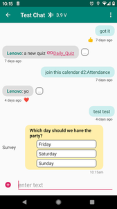

  • Group chats (including surveys, quizzes and emoji responses)

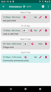

  • Shared Calendars

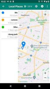

  • Shared Map Places
Here are some screen grabs:

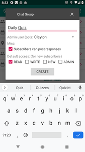

These are all enabled by a new 'shared documents' feature in the latest Repeater firmware. The admin of the network uses the Ripple Commander app to create these shared documents, and sets the permissions.
In the above example, the admin is creating a group chat that only has READ access for new subscribers, and only the 'Clayton' user will be posting new messages. This can be for an 'Announcements'-style group, or in this case, will be 'Daily Quiz', as messages can now also be a Survey or Quiz question.
Ripple Messenger users join/subscribe to the documents/groups by scanning QR codes which the Commander app generates, or they can be joined by inserting 'document links' in text messages, for instance in an existing Announcements group chat you can announce new documents with a clickable link.
