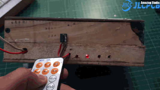

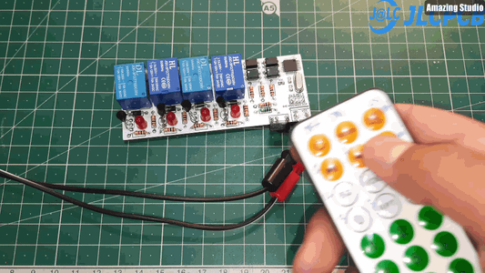

Step 3: Working in Brief:
The infrared signal from Remote is received by the Receiver section of the board (containing TSOP1738 IR receiver). Then this binary code is given to the microcontroller to process the signal. This Binary is converted in HEX code; then, there will be an ON/OFF action according to every pressed button. The microcontroller made its corresponding digital pin to high to control the relay system and then AC mains.

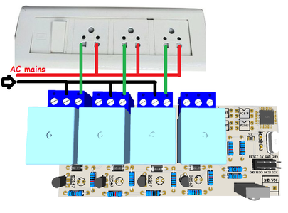

Step 4: Circuit Diagram:
Step 5: Breadboard Schematics:
For one channel, Try this by placing a led Instead of relay, If this one work fine then go ahead.
Step 6: PCB:

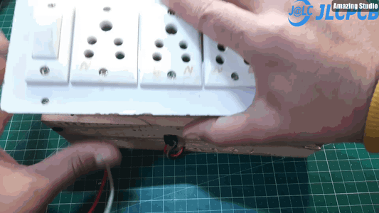

Step 7: Extension Board:
Here we have four outputs to connect to our 4-channel relay system. But the space inside the wooden box of extension is significantly less. So, we extended it using another wooden stick to solve the problem of space.
Step 8: Connections:

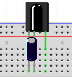

All the components are fixed inside the wooden box and glued correctly; make sure while making connections with TSOP1738, the wire length is not too long and use copper wires. Also, add a capacitor between the two legs of TSOP (470uf can do the job perfectly).
Use thick copper wire while making connections of AC mains. Then there will be a low dropout of voltage, and it will not overheat the circuity.

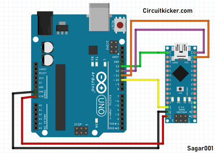

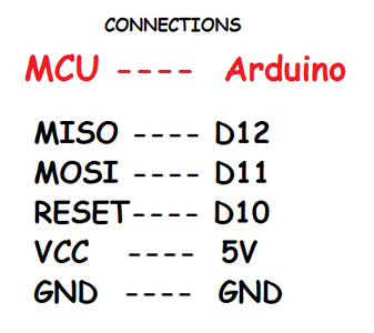

Step 10: Microcontroller:
Here, we are using the SMD version of the microcontroller and headers is given to program the microcontroller. Now let’s program the microcontroller, Connect the pins in this format, and upload the code simply using Arduino as the ISP function. For more info, check this post.

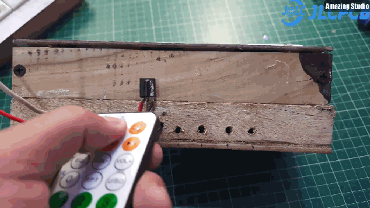

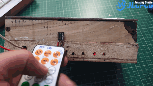

Every button in IR remote has different hex number data, if we want to turn ON/OFF a device, we need two buttons of IR remote. One to switch ON and other one to switch OFF the same device.
Similarly, here we are making 3 channel relay controllers, that’s why we need 6 different buttons. Also, when we want to switch ON/OFF all the devices at same time, we need two more buttons. In total our IR remote should have 8 buttons.
When remote release IR hex data, it will be captured at receiver end and microcontroller decode the data, immediately turn ON/OFF the respective pin.

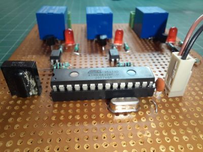

Step 13: Version 1:
I posted version ONE of this circuit some time ago, but one is also working well. Circuit is designed on a general purpose holed pcb. You may get more info about the code, circuit from here.
