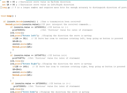

Step 3: Step 3: Programming the Device
I have attached the code to help with the coding of your own remote control camera, but as a run through here is a summary.
First we set up each of our devices, using IRremote.h, wire.h, servo.h to run the program.
Second, because we are going to be using this as an internal interrupt program, we take in the receivers inputs and catch the results and determine if a real value is seen, and then if it is one of the four buttons in question.
Third, we set up our commands for these if statements, four separate conditions, up down left and right, each with a built in limit so we don't crash our servos.
From here, the fourth step is to add in a button hold reading and go back to the main if statements and set a parameter to recognize what button is being held. This is done by setting a variable (p in this case) to the initial input signal, and later asking the program if it sees the 'button being held' value what value of p it has so that it can know which way to continue to move until it reaches its built in limit.
After it finishes this command it exits the interrupt.
