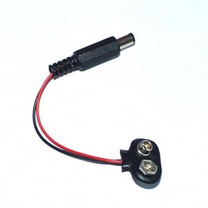

- Power supply(9-24V)-as per requirement

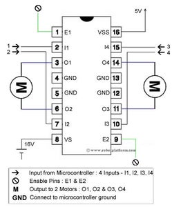

Step 3: Connections
Made Connections as shown in figure
L293D
- We use it because maxiumum output from Arduino is 5V. But our motor require more than that --about 9V-32V, therefore this IC provide voltage ouput to our motors equal to the the voltage we supply to its 8th pin.
- Here enable pins enable their respective side pins for example: EN pin 1 enables the pins 2,3,6,7. In same way En pin 9 dose.
- provide about 5V to pin no. 1,9,16.
- 16 pin no. require 5v for IC internal working.

- Don't input voltage more than 12v and less than 6v for its proper working.a
- Paste double sided tape below Arduino to prevent shot circuiting of pins.

- Pin diagram is shown in fig.
NOTE:keep all connections tight for proper working of circuit.
