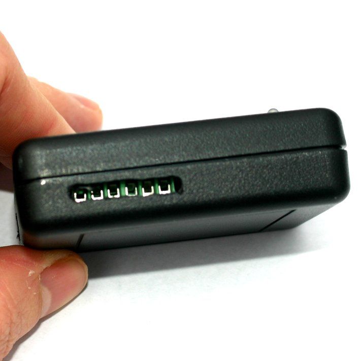

Step 2: Controller
Connecting the parts are quite simple. It only takes a USB cable, three wires for the servo, and power. If you want to go wireless, you can use a Bluetooth Multi-thing controller for local control or consider the Daisy WiFi via the Internet Your Thing Kickstarter project.
Servos generally require a little more power than the USB can provide, so we recommend an alternate power source. We just used an old 9 or 12 volt power adapter from something that broke long ago.
