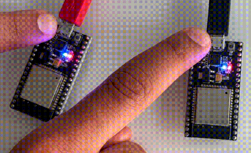

In this project we'll connect two ESP32 boards to each other wirelessly using the MQTT protocol. We will take advantage of the power and flexibility of MicroPython to get the project up and running quickly!

Step 5: Save Bootup Code and Application Code to First ESP32
You will need to use the Thonny editor to upload these files to your microcontroller.
  1. The bootup code connects to WiFi and is found in boot.py.
  2. Make sure to set the WIFI_NAME and WIFI_PASS to your own WiFi network's username and password.
  3. The application code is in main.py and it does all the MQTT work of connecting, publishing and subscribing.
  4. Make sure to replace the broker IP address with your computer's IP address.
  5. Make sure to replace pin numbers (0 and 2) with the correct pin number for the button and LED on your ESP32 board's pinout diagram / datasheet. It's not always the same.
Step 6: Save Bootup Code and Application to Second ESP32
The files are the same as above, with one major exception: change all references to "blue" to "green", and "green" to "blue" in the main.py code. This is so the MQTT broker can differentiate each microcontroller from each other, by device name and MQTT topic names.
Step 7: Restart Both ESP32s and Try It Out!
Each button press should light the LED on the other microcontroller! Yay, a remote controlled light :D
