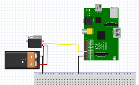

Step 3: Wiring It Up
Mount the breadboard, battery pack, Raspberry Pi, and motor to a sheet of plastic or wood.
Wire up the motor, RPi, and battery like above.
