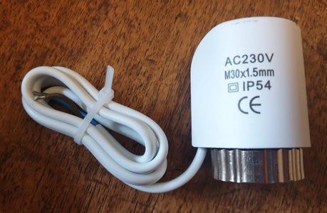

Valves: There are several types of valve on ebay, some 24V, most 240V, some normally open, some normally closed. I'd very strongly recommend sticking to 24V, although I've done a couple of 240v. NO or NC isn't critical, because you set up your Home Assistant automations to control them appropriately. Probably when the boiler's on, most radiators are on, so they spend more time open - Normally Open might be best. The best type I've found is the last pictured, pear-shaped with a grill on the top, and the little window to show the valve position. The very common type pictured first, which is all over ebay and you buy straight from China - it's ok, but I've found I've had to adjust the mounting, rather than screw it right down, whereas the white, pear-shaped one has been excellent (only problem: I don't know who makes them - I just saw them being sold off on ebay, seemingly from surplus stock.)

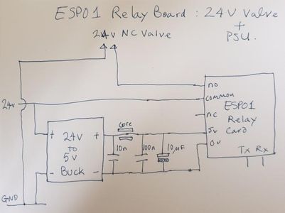

  1. 24V system with ESP01 board, 24v to 5v buck converter and smoothing components

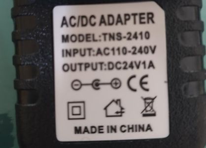

Transformer: if you do 24v, a cheap 13A plug PSU is easy to find on ebay. Lowest amps you find, probably 1A, unless you see 500mA. I metered a valve & it was about 3.5w when cold, 2.5w when warmed up. That's 250mA plus electronics - not much.

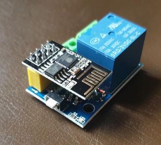

Step 1: ESP-01 Based 24V Valve Controller
This is more soldering and understanding than the single board approach, but it's interesting, and physically quite compact.
This solution is 24V only. Parts are:
  1. 24V 1A 13A plug transformer
  2. ESP-01

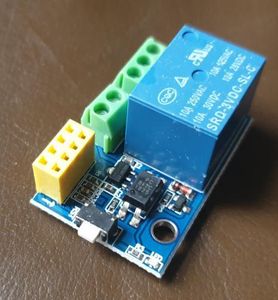

  3. ESP-01 relay card

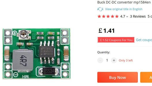

  4. 24V to 5V buck converter
  5. 100n and 10n polyester capacitors,10microFarad electrolytic capacitor, smallest ferrite bead, small bit of circuit board - that's if you include extra smoothing, see below

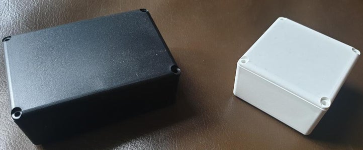

  6. small box - I used 72x48x24mm
  7. 24V thermally actuated valve

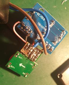

The ESP8266 is an amazing little microcontroller, complete with Wifi, for a couple of quid. It's a little sensitive to noise on the PSU sometimes. All these Chinese PSUs and converters are very much made to the price, and can be noisy. Therefore I added smoothing between the buck converter and the 5V ESP-01 relay board.

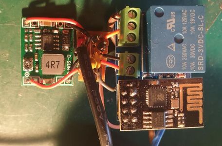

The buck converter I used has a variable output voltage, and I needed to set it carefully with a watchmaker's Philips screwdriver in the tiny potentiometer, and a multimeter to check voltage.
You can see that I've overdone the miniaturisation, and that the vero-board part is unmanageably small. In fact I'm far from sure it's even needed - probably the ESP-01 would work fine with just the buck converter and no smoothing capacitors or ferrite bead.
See how I've soldered to the backs of boards here and there - you need a fine, clean soldering iron tip and a little skill.
It might not be easy to add a DHT22 sensor, and I haven't tried.

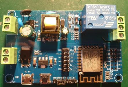

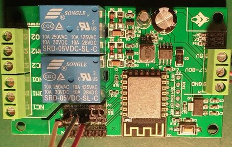

Step 2: ESP-12f Relay Board - 24V
This is a simpler and neater solution than the ESP-01 method above. The ESP-12f is superior - 4Mb of memory over 1Mb, and more GPIOs are available. It is easy to add a DHT22 if you want the electronics box to have a temperature/humidity sensor, which Home Assistant can use to control turning radiators on and off. The box need not necessarily be right next to the valve (you choose the length of wire between box and valve,) so that the temperature sensor can be pretty usefully located, away from the distorting effect of the radiator.

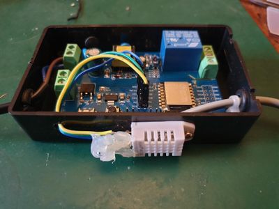

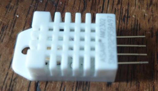

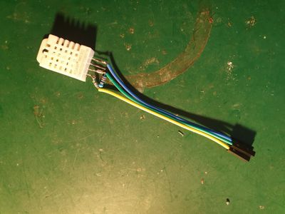

If you add the DHT22 it has 4 pins, but only 3 are used (see copious info on the web.) It needs a pull-up resistor, I used 6.8K, between "sense" and Vcc - see how I soldered that with the wires, onto the sensor (rather than inside the box.) This gives a sensor that can be disconnected from the main board if necessary, which is much easier to build, and dismantle if you want to. Be quite clear which I/O pin number you've plugged into, so that you can configure it (see on.)
These boards are fantastic. They take any DC voltage from something like 12v to 80v. We are using 24V for the valve, so it's very neat: one power source for board and valve. It's also very safe: all the mains voltage is inside the 13A plug PSU, safely insulated in an official, manufactured part.

A very similar board to the one in the last step can be had with a little 240V switch mode power supply on it, for hardly any more. I think I paid £8 instead of about £6. Amazing!
Yet - I really dislike mains voltage. You risk shock and fire - why take the risk?
That said, it's easy. On mine I have the DHT22 option (notice I've used hot plastic to protect the dht22 wires - I got this slightly wrong and this photo is from before a re-melt and reform of it.) I would say though that given there's 240V inside, adding a DHT22 is a further needless risk, so again - I think we should stick to 24V for this project, because it's cheap, neat, easy and safe.
These boards are a bit bigger. There's a 10x6x2.5cm box on ebay that's quite cheap.

It should be a matter of unscrewing your old thermostatic valve, and screwing on the electric one. You will probably need to press quite hard as you do so.
It's interesting - the travel of the valve seems very slight, maybe 5 or 6 mm as far as I can see, yet all the valves I've tried do seem to have worked well. The one pictured, I forget its make, might have slightly less thread: it wouldn't go on one of my radiators, whereas the others did.

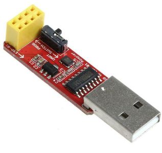

Uploading code is different for the ESP-01 and ESP-12f boards. Make sure you select the right memory and file system size on the tool menus. For ESP-01 it's 1Mb, for ESP-12f it's 4Mb (Arduino might auto-detect, no guarantees.) Select the smallest size File System you see, leaving the max for OTA to work (and it will just work on ESP-01!)

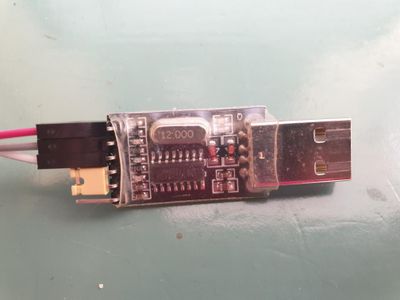

ESP-01 - you unplug, and plug into the USB/ESP-01 serial adapter, and into your Arduino environment's PC's serial board.

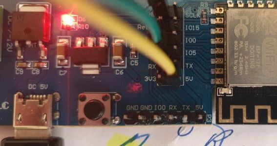

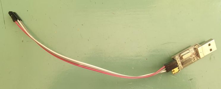

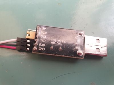

ESP-12f cards - you need to get a plain USB to serial adapter, see photos, and use a 3 way ribbon connector to get TX, RX and Gnd to the board (see the picture of one of the boards connectors, but they differ slightly.) Note that you have to reverse TX and RX between board and plug, so that the board's TX goes to the plug's RX and vice versa (otherwise you're transmitting to a transmitter, if you see what I mean.)
Be sure you understand in both cases the difference between program and run modes. ESP8266 re-uses I/O lines for uploading, and you have to ground IO0 to set this mode. The ESP-01 USB adapter has a little switch for this, but for the ESP-12 you'll need to use the little jumper that comes with the board to bridge GND and IO0 (see the photo - no jumper installed when taken.)

If you set detector_type you're configuring a temperature/humidity detector. Use a dht22. You can use a dht11, they're cheaper - but don't bother.
You can have 0 or more relays, that's why the JSON array. Normally you'll just have one GPIO for the relay, but I have one useful board with 2 relays, that controls my bedroom and the hall outside's radiators. Then you have two GPIOs (and 2 sets of mqtt things, see below.) You do need to work out which GPIO(s) from card documentation. Some relay cards need you to add jumpers between a relay pin and a GPIO pin (my dual relay one is the one I encountered that on.)

Notice that you can monitor the temperature and humidity against a known thermometer, and set corrections into the config file. dht22s can need 2 or 3 degrees sometimes! dht22 are also quite noisy. I expect commercial ones are too (like the Tuya zigbee thermometer, which is excellent value,) but they'll have smoothing code. I have done this by using a Hampel library for knocking out outliers, so that my thermometers are almost as smooth as Tuyas. If you run the board with a serial montior you'll see debug code showing when outliers are dropped. You can tune the outlier parameters, the number of samples and the sampling frequency, but I hope you find what I've worked towards suitable.
