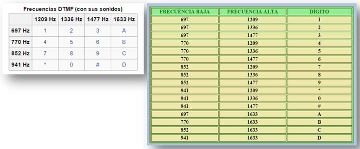

In telecommunications, DTMF (Dual-tone multi-frequency), also known as multi-frequency system and/or tone dialing system, is a signaling of analog telephone lines, consisting of pairs of audible tones that are handled in the range of frequencies of the human voice and are obtained when the buttons of an alphanumeric keyboard are pressed.
A valid DTMF signal can be obtained by the sum of two tones, one from a high frequency group and a low frequency group; each group contains 4 individual tones. Each tone will be made up of cosines that correspond to a high frequency and another low sequence, in addition, it can decode the numbers from 0 to 9, symbols such as '*' and '#', additionally it has some letters such as: ' A', 'B', 'C' and 'D'.

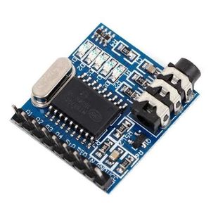

Step 1: Understanding the Tone Decoder
The MT8870CE manufactured by MITEL is a specialized electronic circuit to perform the task to decode the double tones generated by the keyboard of a telephone in digital mode, these tones are decoded and then converted to 4-bit binary quantities corresponding to a given numerical value. These binary values ​​work as commands or data according to the order in which they are entered into the control system. This DTMF signal decoder is provided in addition to the features already mentioned, from a terminal indicating whether a valid DTMF signal has been received, decoded and its corresponding binary code captured in the output register, this terminal is called StD.

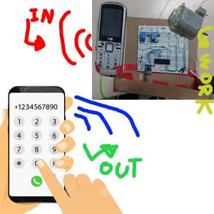

To carry out the tone decoding test, we used an android mobile phone with the DTMF tone generator application, as well as a ZTE-G R228 phone, which allowed us to connect the headset and answer and hang up a call, as well as send the audio signal. required for the CM8870.

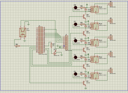

Step 2: Circuit
este proyecto lo tenia guardado entre mis archivos y algunas cosas se me ha perdido pero intentare explicar de forma breve la lógica de funcionamiento, lo esencial es desde una llamada con el celular podemos controlar el encendido apagado de alguna maquina por medio de los tonos generados al marcar los números en la llamada, entonces necesitamos 1 celular para realizar la llamada y al otro lado (a distancia) cerca a la maquina un celular conectado al decodificador, luego al microcontrolador y de sus salidas unos relés que actúan como switch de alguna maquina
