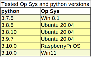

To run the Remote UI you need a PC with either Windows or Linux operating system, or a Raspberry Pi 2+ or higher with a recent Raspberry Pi OS with desktop. Screen resolution needs to be 1024x768 or larger.
We need Python 3.7 or higher installed as well as the modules tkinter and pyserial.
I did test the RemoteUI on Windows 8.1 (on a laptop), Windows 11, Ubuntu 20.04 (on a laptop and PC) and the Raspberry Pi OS release of 28-Jan-2022 (bullseye) on a Raspberry Pi 3+. I do not have a Mac, using python tkinter to build the UI, the RemoteUI should run on a Mac as well. For tested operating systems vs. python versions, please refer to the picture.

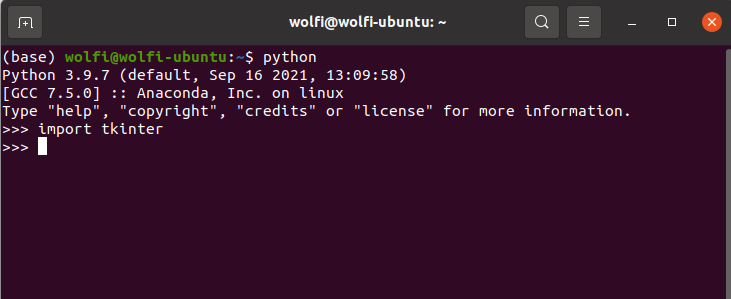

Check for Tkinter and pyserial:
Open a terminal / console window and type: python (python3). On the >>> prompt type import tkinter. If the >>> prompt returns without an error message, good.
Then type >>> import pyserial. If the >>> prompt returns without an error message again, perfect, we are good to go.
If you get a "ModuleNotFoundError:" you need to install the missing module.
If no error, jump down to "Download and run the RemoteUI".

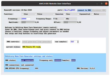

The remoteUI should start and look similar to attached picture. Step 4 will describe the usage of the RemoteUI.

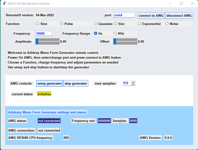

Step 3: Installing on a Windows System

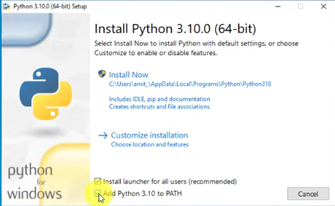

If you need to install Python on your Windows system please see the python.org/downloads site. I recommend to use the "Latest Python 3 Release" (currently 3.10.2). You need to scroll down a bit on the download page, then select the version which fits to your Windows system (32 or 64 bit). I am using the windows installer version.
One important remark: do not forget to tick the box "add Python 3.xx to path". (see picture)

Download and run the RemoteUI:
Download the Python file AWGremote.py attached to Step2 to your working directory or your desktop. The file is the same for Linux and Windows.
If you copied to desktop double-click the RemoteUI icon. Alternatively open a terminal, change to your working directory and start the RemoteUI by typing:
python ./AWGremote.py

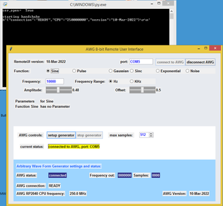

The remoteUI should start, see picture.

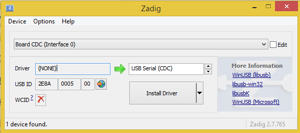

Remark: If you are using Windows 8.1, you need to install a driver to connect to the RP2040 pico board via USB. I am using the open source software Zadig to do the driver installation, as Microsoft update does not find a suitable driver. If you use Zadig, please select the "USB serial driver" (see picture). The pico board should then show in device manager under COM&LPT as "Board CDC (Interface0) COMxx". COMxx is the port to use when connecting to the AWG.

The RemoteUI has three sections (see picture for details):
  1. The top section (gray color) displays the version date on the top left side. On the top right side is the field to enter the port and two buttons to connect and disconnect the AWG. Next below is the main entry area to set up a wave. It has entry fields for function, frequency and frequency range, sliders for amplitude and offset and, depending on the function selected, one or more entry fields for the parameters of the wave. If you start the RemoteUI, the parameter section displayes few instructions on how to use the RemoteUI.
  2. The middle section (white color) shows the controls for the AWG: a setup and stop generator button and a field to chose the number of samples the AWG should use to calculate the wave. Higher sample rates provide more accuracy, but take longer to calculate. The default value is 512 samples. Below the controls is a status/message field (yellow background color), which displays messages and status information.
  3. The bottom section (blue color) shows the AWG status and version. All that data is sent from AWG to the RemoteUI. The dark blue colored fields change during usage. They display actual AWG status, AWG output frequency and number of samples used for the calculated wave.

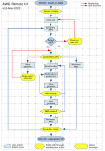

The control flow is attached as a picture and pdf. Please have a look it shows the possible actions a user can take and (most of) the status messages.
The user interface is programmed to be context sensitive, which means:
  • Only the buttons which make sense in a step in the control flow are enabled, the others are "greyed out".
  • When a wave is selected the parameters which can be adjusted for that wave are displayed.
  • When a wave is selected amplitude, offset and the parameters are set to a default value, so if you press the setup generator button, you get a consistent wave as output.
  • All parameters are bracketed, so you cannot adjust a parameter to out of range.
  • Amplitude and Offset are intentionally not bracketed, this gives flexibility to the user, e.g. to generate "clipped" waves by adjusting the offset or increasing the amplitude.

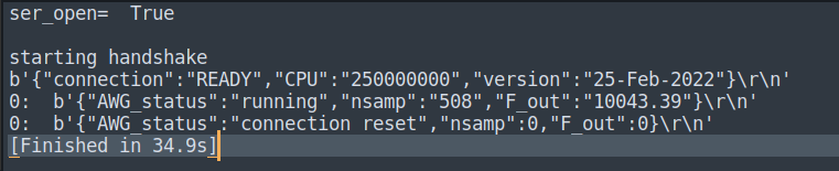

RemoteUI and AWG connect with a handshake. When you plug the AWG to the computer's USB port it starts up and blinks once the onboard LED to signal that it is ready for connection. Start the RemoteUI as described in the installation sections, enter the port and press the connect to AWG button.
It does not matter if you start the RemoteUI first or plug the AWG first to the computer's USB port, just make sure the AWG is plugged to the USB of the computer before you click the connect to AWG button.
If the connection is established, the current status changes to "connected to AWG on port..." and the AWG status shows connected
If you start the RemoteUI python program either a terminal/console window is open or python opens one. In that terminal window python displays print() and error messages of the python program. The picture attached shows an example of messages upon connection, after pressing the setup generator button and after disconnect.
Remark: If you unplug and re-plug the USB cable, make sure you check if the port is still the same, esp. on Linux systems the port may change

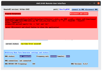

  • Should a user produce an error, the program displays a message in the current status field.Typically the user can recover by changing an entry or press a (different) button.
  • Program errors, which cannot be recovered result in an Error message (see example picture). The user will need to exit the program by pressing the disconnect and close button. The program tries to reset the connection to the AWG, the AWG does a soft reset and returns to the state, where the RemoteUI can open the connection again once restarted.
  • Should the program not be able to reset the AWG connection upon exiting from an error state, the user needs to press the AWG's reset button or unplug and re-plug the USB cable (hard reset).

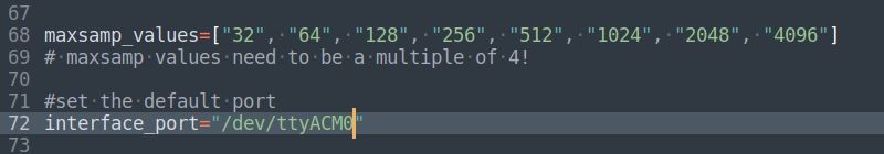

  • There are two variables in the file AWGremote.py you might want to change (refer to attached picture):
  • The variable interface_port on line 72 defines the default port. If you are working with the same computer all the time, you might want to change the value to the port you always use. E.g. on Windows it is a COMxx port. Changing the variable avoids that you have to override the port each time you start the RemoteUI. Save the file after the change was made.
  • The variable maxsamp_values (line 68) holds the list with the valid numbers of samples the AWG uses to calculate the wave. You can add or remove values. Be aware the value must be a multiple of 4 and if you enter values larger than 4096, you need to adjust the buffer size in the file AWG.py in lines 81 and 82 as well to the largest number of samples you want to use. If you use a large number, make sure the RP2040 does not run out of memory.
