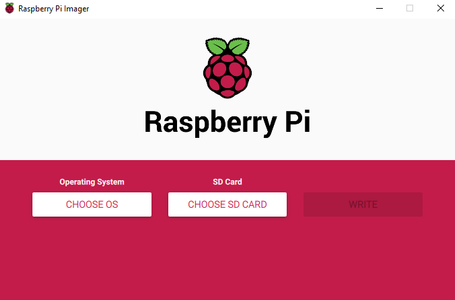

Then download raspberry pi imager from this link: https://www.raspberrypi.com/software/
You can install any version of the Raspberry Pi OS (Lite/Normal/Full) you want into the SD card.
Put the Micro SD into the Raspberry slot and boot it on!
