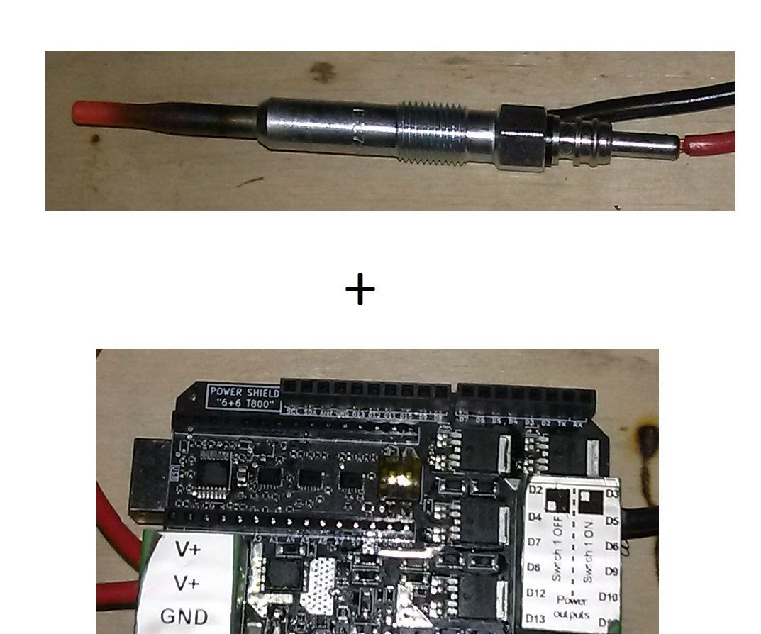

2. Multifunctional POWER SHIELD 6+6 T800 for Arduino from v-vTech,com

Assemble 10 battery cells holder in series, mark each cell location avoiding confusion and check voltage with multi meter after connection in series, you should get 3 wires with two potentials: one 18-21V for powering Multi functional POWER SHIELD 6+6 T800 (maximum input up to 32V MAX), two for 36- 42V for powering LED's positive terminals.
Also it is recommended to put on POWER SHIELD input capacitor with parameters 2200uF/35V.

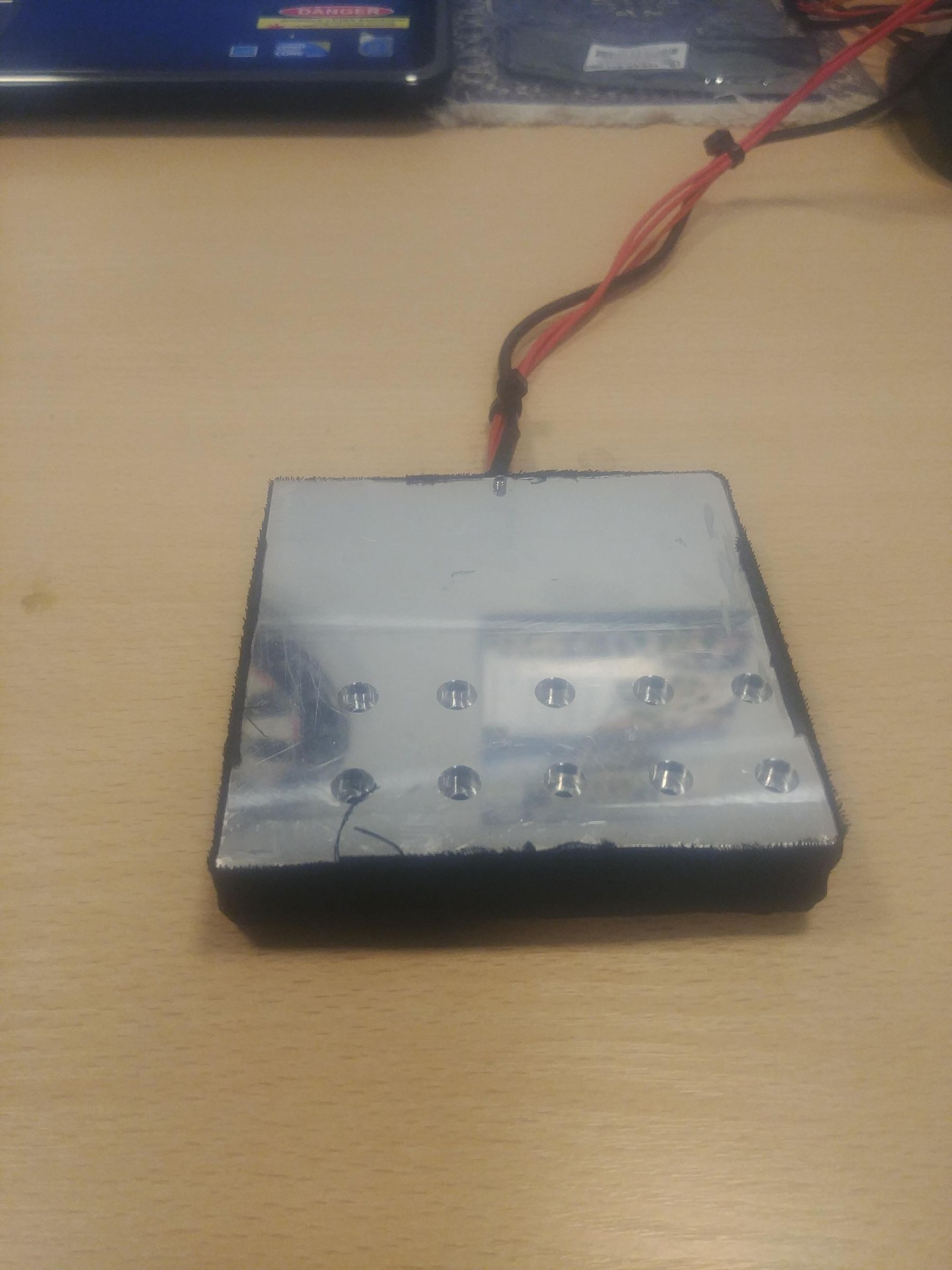

Fix 6x100-150W LEDs with bolts and cooling paste
Solder wires ~15cm. and feed trough drilled holes into the center of cube.
Fix 4 corners.
Step 4: Frame Assembly
Assemble 5 sides of cube and drill hole for re-settable fuse.
