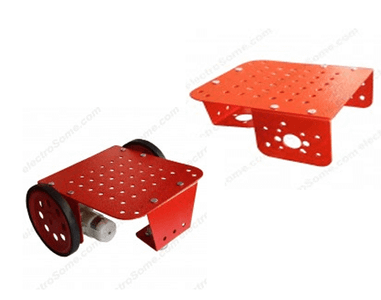

3. Car Chassis

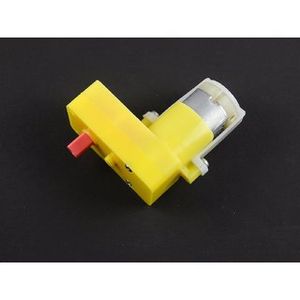

4. BO Motor

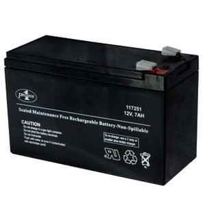

5. 9V Battery ( Better if it is 12V 7AH Rechargeable Battery for better performance )

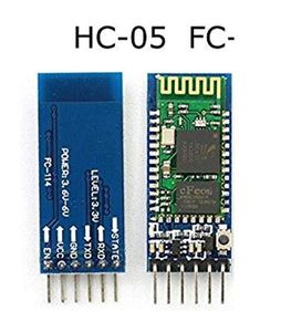

Bluetooth Module: It has a VCC, GND, Tx, Rx Pins. What you have to take care of is that Tx and Rx pins shouldn't be connected when the Code is being uploaded. Tx and Rx of Bluetooth must connect to the Rx and Tx of Arduino respectively.
