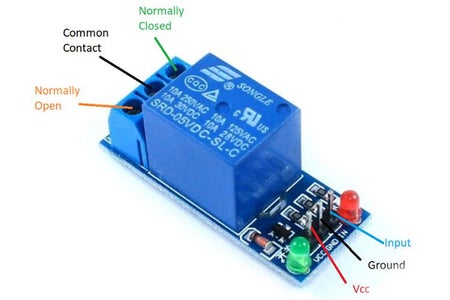

  6. single channel Relay module

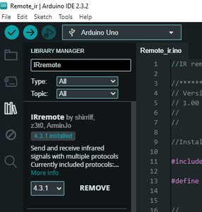

Step 1: Download Required Libraries!
To use an infrared remote, download the IRremote library in the Arduino IDE as shown in the image.
I found this online code file which has been attached herewith. It will allow you to receive your IR remote signals and will provide you with codes for each one of your remote button
Attach your IR receiver on pin 2 of the Arduino UNO for the code to work. After executing the code you will find your remote button codes on the serial monitor as you use them

Connect your relay module as shown in the above schematic.
Finally allow the attached code to run with proper connections in the circuit...and...,Voila! Your Light bulb now works on remote!(I have attached the relay on pin 13, so pin 13 is set to HIGH or LOW when the light bulb is to be used)
