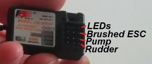

Now it's time to do a bit of soldering, to connect the connectors and the extensions.
Basically I'll have 4 connectors.
3 that I'm going to plug into a 3 channel receiver and 1 into the ESC for brushed motors (link in the description).
I've attached a servo horn to the top of the fake offshore motor and, using a paper clip, I've connected it to the servo.
As you can see, It works like a charm!
Step 7: Tyding Up and Connecting the Receiver
I've cabled all the wires inside the hull, using other zipties.
After that, I've connected all the cables to the receiver.

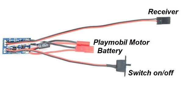

Step 8: Connecting the Brushed ESC and Installing the Battery
I've connected the Playmobil Underwater Motor cables to the Brushed ESC (link in the description), installing the switch on one of the "manual" plastic tank*, aside the driver seat.
