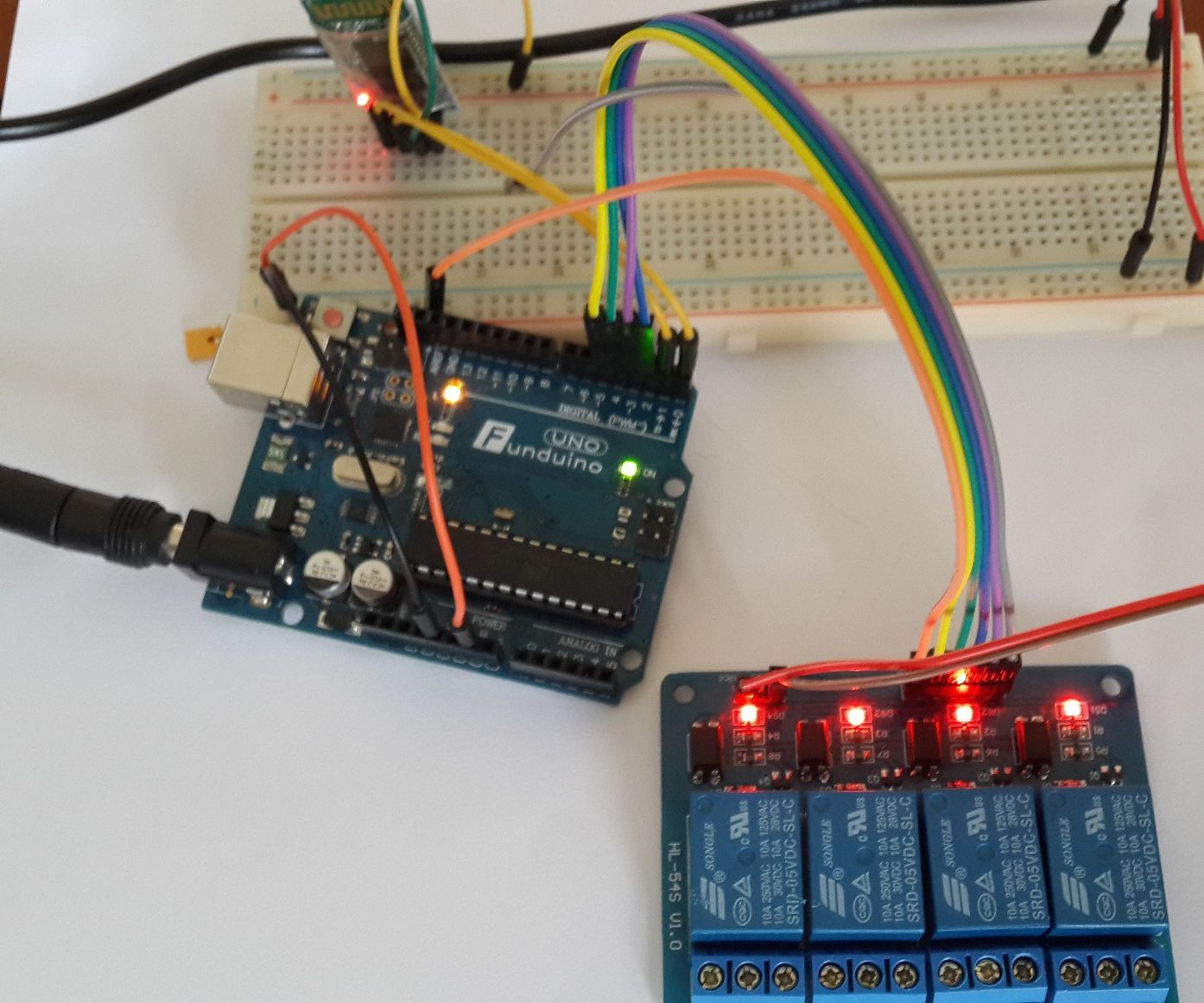

Step 2: Step 2: Function and Operation
For this design to function there has to be a mechanism that locks the door in a manner which ensures that it can withstand the possible forces exerted on it by means of intrusion. A dead-bolt (steel bar that can retract and advance, usually into the frame of doors) was chosen as the method of preventing those forces. This is then propelled by a servo motor causing either retraction or advancement of the dead-bolt.
The action of the motor is controlled by indirectly controlled by the receiver. When the button on the remote is pressed the signal it sends out is received by the receiver. As the receiver has a relay on the inside, it is then switched from the open to the closed position which then sends a signal to the Arduino Uno that tells the program to move to the next specified piece of code. When this jump is made to the specified piece of code, the servo motor in turn then actuates and pushes the dead-bolt forward into the door frame. Consequently pressing the button the second time will cause the servo motor to actuate in the opposite direction and retract the dead-bolt from the door frame.
Step 3: Step 3: Connection and Interactions Between Parts
The servo motor is connected to the live, ground and to the 3rd dc output port which is a PWM port (clock port) on the Arduino Uno. The receiver is connected to the second port of the Arduino and connected to a resistor and live (5 volt Arduino output) in series and then to Normally Open port of the receiver. The common port is directly connected to ground. Then lastly the receiver is connected to a 12 volt dc power source

Step 5: Step 5: Progamming
Coding and explanation of coding for Arduino Uno
#include // include servo header file
Servo myservo; // create servo object to control a servo
int pos = 0; // variable to store the servo position
int remotePin = 2; // set pin for remote input
int servoPin = 3; // set pin for servo
int openState = 1; // variable to store mechanism position (1 if open; 0 if closed)
int x = 5; // stores time to delay before next position is sent to servo
// also helps to set speed of mechanism and debounces switch input
void setup()
pinMode(2, INPUT); // set pin 2 as input
myservo.attach(servoPin); // attaches the servo on pin 3 to the servo object
void loop()
if(digitalRead(remotePin)) //checks if remote has been pressed
if(openState) //checks if mechanism is open
for(pos = 1; pos < 179; pos += 1) // goes from 10 degrees to 180 degrees
{ // in steps of 1 degree
myservo.write(pos); // tell servo to go to position in variable 'pos'
openState = 0; // sets state to closed
delay(x); // waits x ms for the servo to reach the position
else //checks if mechanism is closed
for(pos = 179; pos>=1; pos-=1) // goes from 180 degrees to 10 degrees
openState = 1; // sets state to open
else
{} // do nothing if remote pin is not active
