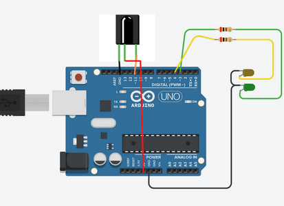

Step 1:

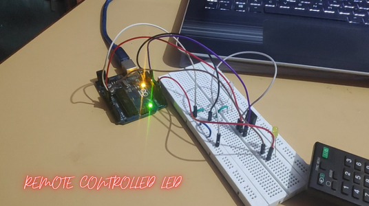

Step 3: WORKING MODEL
Step 4: HEX CODE ='16'(AFTER PRESSING BUTTON 1 IN REMOTE)
AFTER BUTTON 1 PRESSED GREEN LED WILL TURN ON
Step 5: HEX CODE ='2064'(AFTER PRESSING BUTTON 2 IN REMOTE)
AFTER BUTTON 2 PRESSED GREEN LED WILL TURN OOFF
Step 6: HEX CODE ='1040'(AFTER PRESSING BUTTON 3 IN REMOTE)
AFTER BUTTON 3 PRESSED YELLOW LED WILL TURN ON
Step 7: HEX CODE ='3088'(AFTER PRESSING BUTTON 4 IN REMOTE)
AFTER BUTTON 4 PRESSED YELLOW LED WILL TURN OFF
