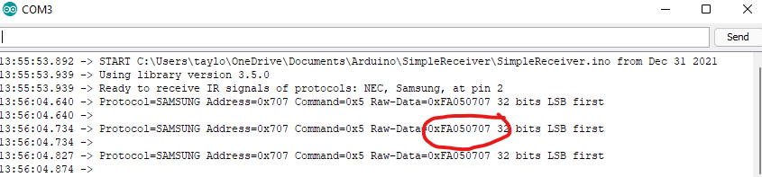

Step 2: Remote Decoding Code
IR decoder code
When your code is uploaded and your IR receiver, point your remote eat the IR receiver and open the com in the top right corner and it will give you a hex number
You are going to use this hex number in the full code
We are using a Samsung remote but if you are using a different brand, just copy and paste it from the code above and replace it with the define Decode_samsung
Step 3: Final Code
Change the Hex Number with your own from the remote decoder, if (data == 0xFB040707) // change according to your IR remote button number
Upload your code to the Arduino, wire the Arduino up to the sensors and light switch and your good to go.
