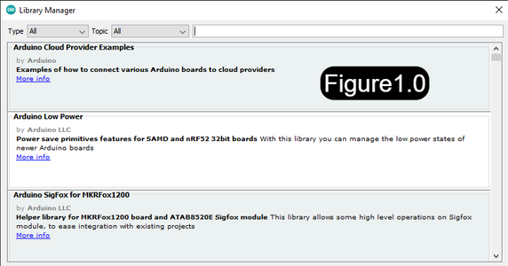

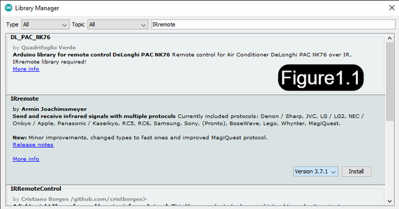

After installing Arduino ,go to tools and click library manager. It will open a new dialogue box which looks like Figure1.0.
In the search bar type "IRremote" and you'll see this(Figure1.1).

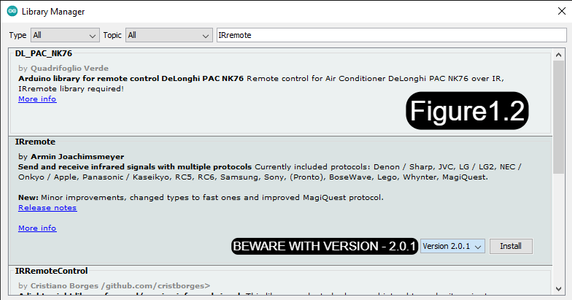

You will see the library "IRremote" and set the version to 2.0.1 (because newer versions are little bit hard to interact with) and click install(Figure1.2).

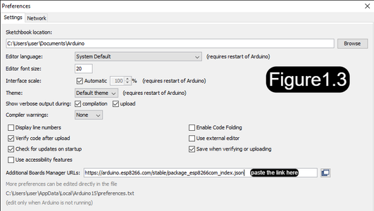

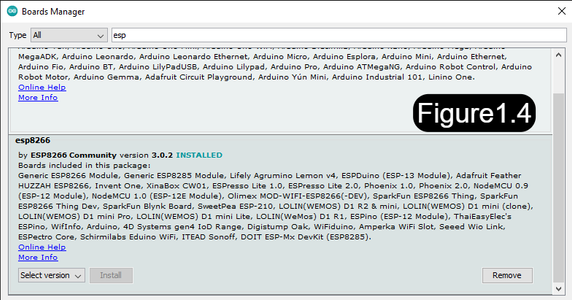

After that go to file and click preferences. Here you can see an empty box named "Additional Boards Manager URLs". paste the link "https://arduino.esp8266.com/stable/package_esp8266com_index.json" in that box and click ok.(Figure1.3)
Then go to Tools and click Boards Manager and in the search bar type ESP (Figure1.4). You can see the board esp8266. Install it by clicking install button.

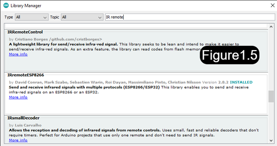

We've already installed a library called "IRremote". Now we have to download another library called "IRremoteESP8266". Go to library manager and search this "IRremoteESP8266" and install here you don't have to worry about the version.(Figure1.5)

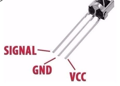

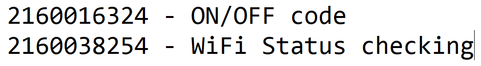

Get the bread board , Arduino NANO , IR receiver, jumper wire and connect the first pin of IR receiver to pin 11. The second one goes to gnd. Third one goes to 5v and upload the code ir_code_checker.ino. (which is provided below). Open up the serial monitor set the baud rate to 9600 and press the button on the remote get your codes. You have to get two codes from two different butons. One to turn the light on/off and another one to check the status of the WiFi.

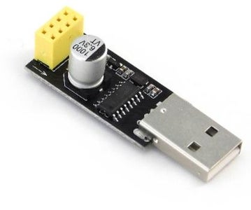

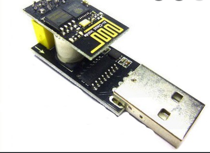

Connect your Esp-01s to your ESP programmer and select the board to Generic ESP8266 module and upload the code given below

  • Fill the on/off ir code right before the comment //Type your on/off code
  • Fill the WiFi status checking IR code right befor the comment //Type your WiFi status checking code

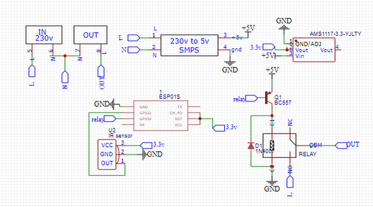

The schematic of the circuit is presented above
NOTE
I didn't add the 47k resistor between transistor base and gpio 0 because it has a resistor inbuilt in esp-01s because I designed the esp-01s myself but the commercial ones don't have that so if you are using a commercial one, you should put that resistor

Step 7: Why Am I Using a PNP Transistor
Because whenever gpio0 pulled down to ground it will go to the programming mode. An NPN transistor allows current to flow from base to emitter and emitter should be connected to ground while using an NPN transistor so the gpio0 will get pulled down to 0v so it will go to programming mode. In order to omit this I used a PNP transistor.
Step 8: What Is the Use of the Diode Here
The diode D1 is here to protect the PNP transistor. Coils have a common behavior which is producing a big voltage spike when we disconnect a dc power source (which is connected beforehand) this would happen in opposite polarity. So the diode is connected across the coil terminals in order suppress that big voltage spike because of this our transistor would be happy.
Step 9: How the Circuit Works
Firstly, when we input 230v in the input the SMPS will step it down to 5v. Then the ams1117-3.3 regulator will step that down to 3.3v because the ESP needs 3.3v to work. The 5v supply is needed to power the relay. Then the esp-01s will execute our code and it will do nothing until we press any of those 2 buttons that we've programmed earlier. If we press the on/off button, it will turn the light on. If we press the WiFi status checking button, it will switch the state of the light depending on the connectivity to the WiFi.
