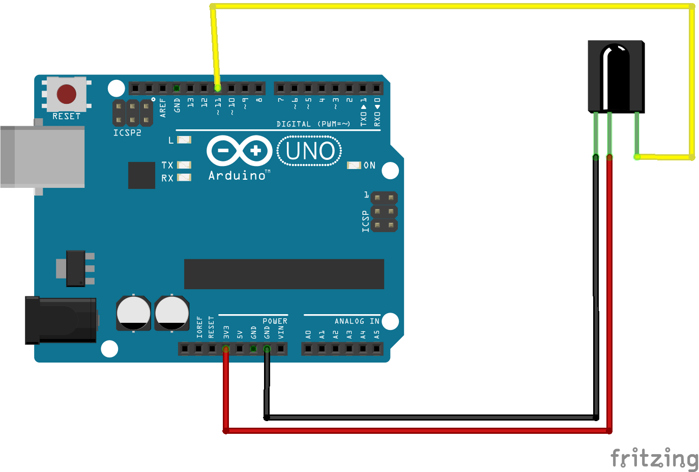

- First you need to connect the parts as per the given circuit diagram
- You can checkout Pin out of TSOP1738 below

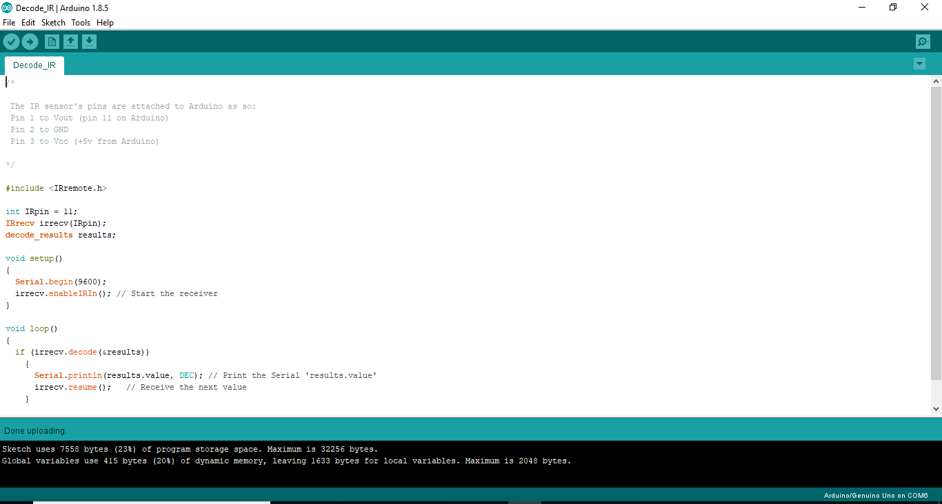

- You can download arduino sketch for decoding IR remote or you can get it from my Github page
- Open Arduino IDE and Upload code

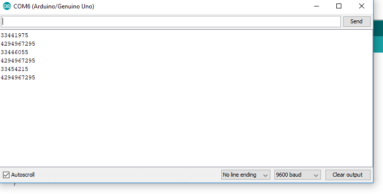

- Open Serial Monitor
- Aim your remote at the sensor and press each button
- you can see different numbers for each button
- Consider any two buttons,and note down decoded values.In my case I have chosen Power button and Mode button.
I got following values
Power button=33441975
Mode button =33446055

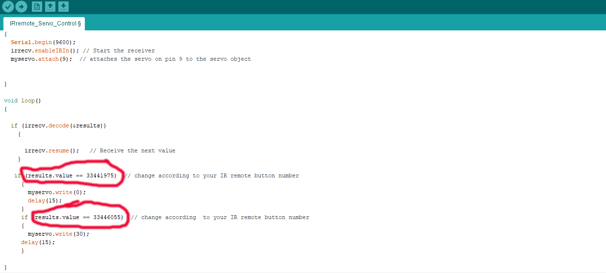

- we will be using this two values to control rotation of servo motor.you need to add this two values in the program which is given on next step

- If all the hardware set-up is connected properly, you can simply compile and upload the sketch to the board.
