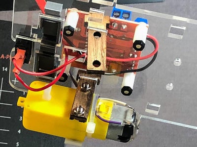

Step 2: Attach Motor Driver
For this step, you will need:
  • 1 Motor Driver
  • 2 Inner Motor Mounts
  • 4 10mm Nylon Spacers
  • 4 Slotted Cheese Head screws M3x0.5 x 16mm
  • 4 3mm Nuts
First, and this is one of the only steps in the entire process where it is necessary that you do these in order, make sure that you put the two inner Motor Mounts in BEFORE the Motor Driver. I've had to make off my Motor Driver a few times because I made this mistake. Once you put the two in, Take the screws and spacers and put them on the Driver as pictured. Then, attach the Motor Driver on the same side as the Opto-Interrupter Mount, and fasten the screws with the Nuts to finish off this step.
Step 3: Assemble the Motor
  • 2 L298 Motors
  • 2 Outer Motor Mounts
  • 1 Switch
  • 2 Wheels
  • 2 Encoder Disks
  • 4 PH Countersunk Flathead Screw M3x0.5 x 30mm
  • 4 M3 Nuts
Before Assembling the car, you will need to solder wires to the metal parts of the Motors as show in the 5th photo. I also recommend that you zip-tie the wires to the motor to receive stain on those little metal tabs, because they can break off easily. You don't need to solder the switch right now, but if you do skip to the wiring step for instructions on how to solder it.
Once you've that, you can assemble all the parts. Start by taking your switch and attaching it to the back of the car. If you have soldered the wires, make sure you route them through the little hole under the Motor Driver. Once you've done that, run the screws through the outer motor mount and motor as pictured in the 4th photo. Although Make sure that you do that in the correct orientation. Although it is not pictured, MAKE SURE you attach the you attach the encoder disks to the motor BEFORE you put them on as shown in photo 7 if you still have the Opto-Interrupters attached. After that, snap the outer motor mount into place and run the rest of the screw through the inner motor mount. Make sure that you route the wires for the motor through the hole above them. To finish it off, use nuts to fasten the whole piece together. Repeat the step for the other side, and you will be finished with the Motor Assembly.

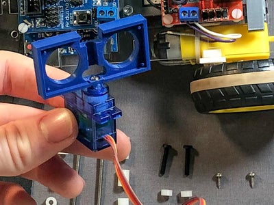

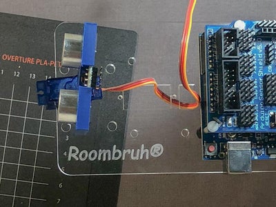

Step 6: Mount the Remaining Sensors
  • 2 TRC5000s
  • 2 Infrared Obstacle Avoidance Modules
  • 1 Ultrasonic Sensor
  • Ultrasonic Mount
  • 2 13 mm Nylon Spacers
  • 2 10 mm Nylon Spacers
  • 2 6 mm Nylon Spacers
  • 2 2 mm Nylon Spacers
  • SG0 9G Micro Servo
  • 2 PH Raised Countersunk Flathead screw M1.6x0.35 x 10 mm
  • 1 PH Raised Countersunk Flathead screw M1.6x0.35 x 8 mm
  • 2 Slotted Cheese Head screws M3x0.5 16 mm
  • 2 Hex Screws M3x0.5 30 mm
  • 2 M3 nuts
  • 2 M3 lock-nuts
First, take the M1.6x0.35 8 mm screw, Ultrasonic Mount, and Servo as fasten them together as pictured above. Then take the Ultrasonic Sensor and friction-fit it into the Ultrasonic Mount. After that, take the Servo-assembly and thread the wire through the two holes shown in the picture, and screw the Servo into the Chasis using the M1.6x0.35 10mm screws. For the TCR5000L assembly, take the Hex screw, 13mm, 10mm, and 6mm Nylon Spacers, and the lock-nut. Put the Hex screw through the Chassis, and the thread the Nylon Spacers through the screw. Attach a TCR facing downwards onto the screw, and tighten a Lock-nut until the TRC is sturdy but able to move. Do not tighten the lock-nuts too tight or you can damage the TRC. Repeat this with the other side. Finally, take the Infrared Obstacle Avoidance Modules, Slotted Cheese head screws, and nuts. Thread the Cheese head screws through the Infrared modules, and attach the 2 mm Nylon spacer. Fasten the module to the Chassis using the nuts, and finish by repeating for the other side.
