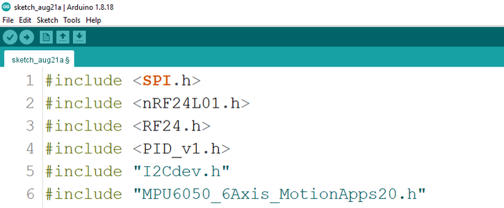

Step 4: Installing Libraries
First Install ARDUINO IDE software.
All Libraries- Use this link, and you will find three folders, now paste these folders into "C:\Users\userName\Documents\Arduino\libraries" in this file directory.
lastly, we need the nrf24l01 library. For this open Arduino ide. Then go to sketch>include library>manage library> search for "rf24" and scroll down you will find "RF24 by TMRH20" Install this library.
Step 5: Including Libraries
- 'SPI.h'and 'nRF24L01.h':These libraries handle communication with the nRF24L01 radio module.
- 'RF24.h': Provides a higher-level interface to control the radio.
- 'PID_v1.h': Implements the PID (Proportional-Integral-Derivative) control algorithm, which is crucial for maintaining balance.
- 'I2Cdev.h' and 'MPU6050_6Axis_MotionApps20.h': Used to interface with the MPU6050 sensor to retrieve orientation data.

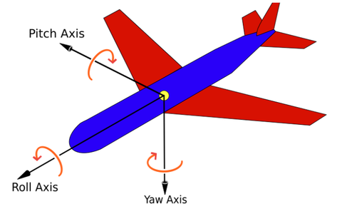

Step 6: Checking MPU 6050 Connections
After adding all required libraries. Upload the example sketch (use image reference) and check if the mpu6050 works. After uploading the sketch move the robot and observe the serial monitor. As you move the robot, you will notice that the yaw, pitch, and roll angles are changing.
At this stage, mark at which angle the pitch is negative and positive. This will help you later.
