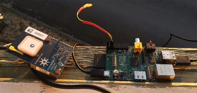

Today we’ll be creating a remote controlled satellite weather station using a Raspberry Pi, a temperature sensor and a RockBLOCK. The envisioned application would be a weather station in a really remote location (i.e. outside of mobile/cellular coverage) – maybe in the middle of the desert, the jungle, or even the arctic – sending its data back to some kind of central weather system.
We’ll keep it really simple, using just one temperature sensor, but additional sensors could be added very easily to expand the scope – to measure humidity, atmospheric pressure or light levels. The temperature sensor used is a Maxim DS18B20 digital thermometer which provides a reasonably accurate reading (+/- 0.5 degrees) over a wide temperature range (-55 to +125C)
The weather station application will periodically transmit its sensor readings using the RockBLOCK. For those of you who don’t know the RockBLOCK, it’s an awesome little module that enables small amounts of data to be sent/received via satellite from anywhere in the world. Ideal for creating all manor of remotely deployed projects, like the weather station! We’ll be utilising the excellent pyRockBlock library (excellent, because it’s written by me!) to take care communicating with the satellites via the RockBLOCK.

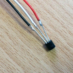

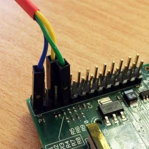

The temperature sensor has three connections: positive, ground and signal – these should be connected to pins 1 (Blue), 4 (Yellow) and 7 (Green) respectively on the Raspberry Pi.
 This module would normally require a pull-up resistor, but this can actually be configured with software with the Raspberry Pi, so no need to get your soldering iron out just yet! Be careful that you connect the sensor correctly, if for example you get the ground and positive mixed up, the sensor will get very hot very quickly!

Step 3: Sending/Receiving Data From Your Weather Station
Messages are sent/received to/from your RockBLOCK using the Rock 7 Core, or the accompanying web-service
For more detailed information on using the accompanying web-service, please check out the Rock 7 Core – Endpoints guide.
