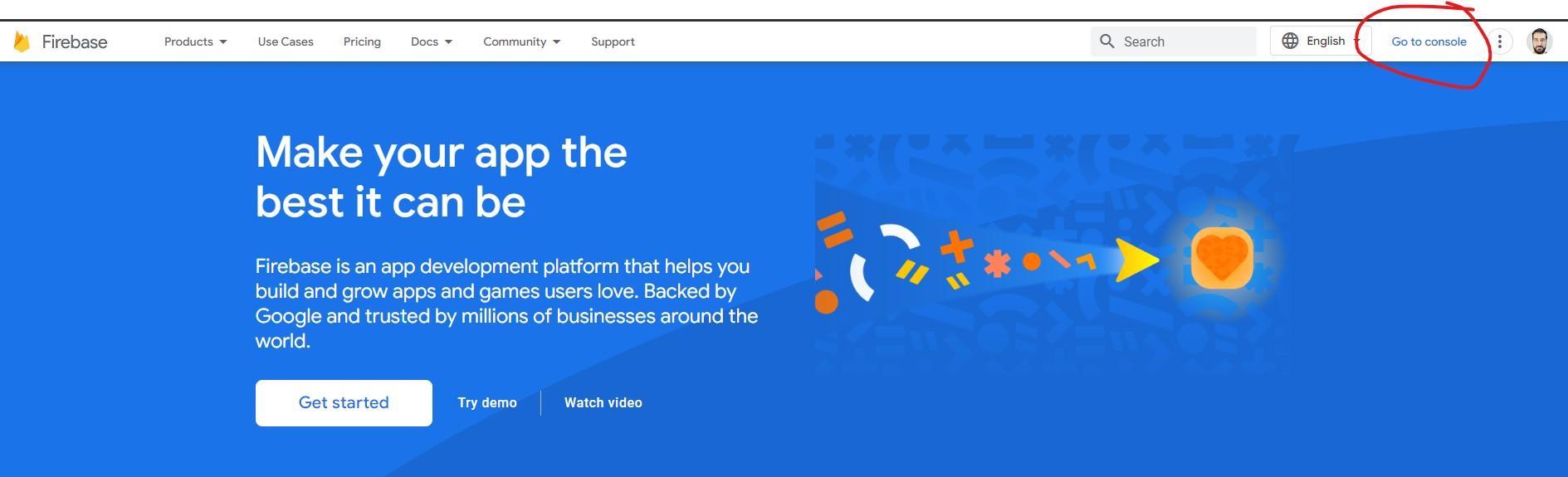

Step 1: Create a Google Firebase Storage
Create a Google Firebase console as link included on supplies
