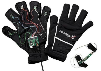

For this project, our principal idea was to create a system using a pair of gloves with which through sensors, the player could control de movement by touching the tip or their fingers. We made some research and found gloves like the following:
AcceleGlove are a pair of gloves with a movement sensor thought to remotely control robots. After this invention, they found different uses like for example, video gaming or sign language translation.

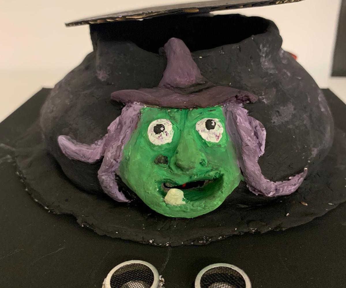

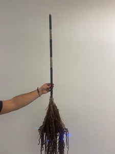

Taking these into consideration, we adapted out idea to it, and also based our final idea on another project. The Enchanted Broom presents a very interesting sensor system, made with two wires that connect to the Arduino and closes a circuit, when the circuit is closed the Arduino is programmed to make the function.
Finally, from these two ideas we developed this project, that results into a personalized fusion of both projects.
