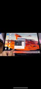

Step 6: Setting Up GUI
Now we would develop the GUI (Graphical user interface)
The GUI serves as a crucial bridge between the users (patients, healthcare providers, and families) and the complex data collected by the remote health monitoring system. The GUI presents real-time and historical data, of heart rate, temperature, and ECG sensor. Patients can view their health metrics, trends, and history, which can empower them to actively manage their health. They can also initiate actions like sharing data with doctors.
Steps to setup the GUI on raspberry pi:
  1. First open the raspberry pi desktop.
  2. Then open the terminal to install some of libraries:
  • pip install firebase-admin
  • python3 -m pip3 install
  • sudo apt install python3-pip3
  1. Now open the Thony editor for writting the code.
Below is the code for the GUI:
Login.py code:
