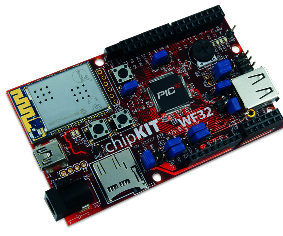

Step 6: Connect Board to Computer
- Connect your WF32 to your computer with the USB cable.
- Ensure the correct board is set in MPIDE as seen in the picture
- Click tool->Serial Port-> Comm #
- If a comm does not show up, check your boards connection to the computer
- Also check that the VU select jumper is on UART, not EXT or USB
- If you want to plug in external power (not the USB power from the computer), you can plug that into the barrel connector input and then switch the VU jumper to EXT.

Step 8: Find the WF32s IP
- After the code is uploaded, click on the serial monitor on the upper right hand corner of the screen (below the X to close the program)
- This should open the monitor which will display all sorts of connection information
- Wait until the monitor says "is linked to physical network" and says "5 sockets listening on IP: ...." The IP is the address of your WF 32. Copy and paste this into a browser window on a computer connected to the same network. Note, do not copy the number after the colon ":80." This just says that the WF32 is on port 80, which it will be by default as this is a commonly used port. Just copy what is drawn around in the picture, and past directly into a browser. I used Google Chrome for this, so I can guarantee the layout will look good on that. I tried others when creating this, but Chrome was the best.
- If you get the message "Unable to connect" in the serial monitor print out, there are a couple options to try:
- First, are your SSID and password typed exactly as they should be in the code? Spaces and capitalization DO matter.
- If this information has been double checked, then try re-uploading the code and trying again. Sometimes it takes a reset to establish a connection.
- Try hitting reset on the board (pictured)
